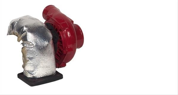

and a couple shots of the engine bay with the DIY turbo wrap from thermo-tec. found at summit.
as you can see i still have plenty of room for a few sheets of paper inbetween there.
