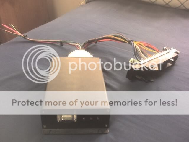

a guy made me the ms harness with my old ecu harness. its a ms1 v3.0 board running msns controling fuel and spark
pic
http://img.photobucket.com/albums/v334/94wvwglxvr6/Photo_030408_002.jpg
all connections on the ms harness have been insulated, and were working fine. ms box lights up while cranking as it is supposed to, and will run fine, ect
the problem is not the ms harness, the problem is the main relay and other wiring in the car. its a mess. srsly, its ugly as fuck.
