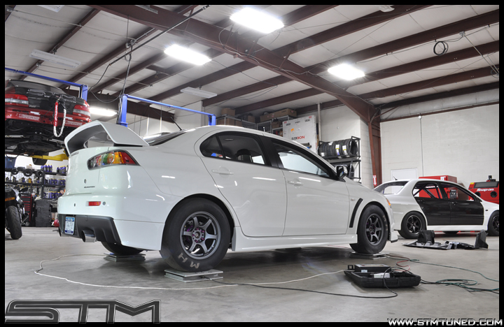

Figured I’d share this. These are the overall fastest X’s for this year so far. I’m sure I will get pushed down the list but looking at their mods they have I think I’m doing alright for bolt on parts lol
that diagonal weight seems real high. congrats on the record though that’s awesome!
Siqqq congrats
Sent from my iPhone 5
Who was driving?
Emery ran the 11.16 at 120. I ran the 11.18 at 121. So I guess it doesn’t really matter who drove right? Haha
Holy fucking deer running across the track!
That fastest evo x list is funny.
‘stock block, stock turbo, bolt ons’
Nearly everyone else on the list has built blocks/aftermarket turbo.
Even more impressive!
sure is! Goes to show what a little weight reduction and a proper setup can do :tup:
exactly what i was thinking great job Chris/Stm crew!! why no meth though?
Also im guess alot of those guys on the list are NOT cuttin 1.4 60’s!!
Are those bellmouth intakes proven to make a difference?
Why would I need to use methanol on the car? It’s just one more thing that can fail and it over complicates things for no reason. As far as the bell mouth intakes, I don’t have a comparison from last year as far as power but swapping to e85 and doing the intake I picked up like 60 hp/70 torque. But I’m sure the smaller brakes and wheel/tire combo had some helping in that too. I wanna say Chris carbee had the prototype and it picked up 30 hp from the factory setup.
