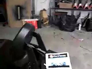

Digital Guard Dawg RFID Keyless ignition. I was sick and tired of the horrible key placement on the Stryker (kept forgetting to remove the key) and I really wanted to be able to have a ‘demo’ and a better understanding of a product I am an authorized dealer for, so I went ahead and picked one up. I absolutely love it… nice and easy, no fumbling with a key, and completely secure since everything is completely tucked away making a ‘hot-wire’ virtually impossible. I had a hell of a time removing the factory ignition cylinder and ended up having to drill off the heads of the security bolts, but it was well worth it in the end. The ignition connectors are completely re-routed so they are not accessible without taking apart the entire bike. It also really cleaned up the front end. I also removed the really crappy audio setup. I’ll eventually do something, but that will have to wait a while.
Before:
After:
Here’s a quick video of the Digital Guard Dawg. Don’t mind the narration, the video was made to put on my website to ‘demo’ the system. Don’t mind the bad quality… it was taken on my phone.
