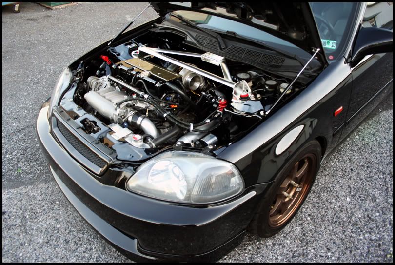

The full setup is as follows:
Stock K20A2 (completely stock everything inside)
RBC intake manifold
Full-Race top-mount T3/44 manifold
Garrett T3/T67 H.O.  (.82 AR exhaust side)
2.5" downpipe (as I cannot fit a 3" with the EKK1 mounts and this manifold)
3" exhaust
TiAL 44mm gate
TiAL Q BOV
2.5" charge piping
Full-Race ver1 vertical flow intercooler
Walbro 255lph in-tank, Bosch 044 inline
ID1000’s @ 60psi base pressure
For those that don’t know the car:
