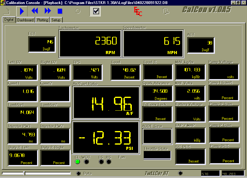

this is what the tweecer program that I currently use looks like, and all of the data is received from a single usb cable from the ECU

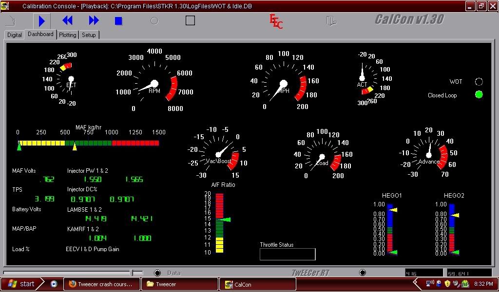

different view of the same data
