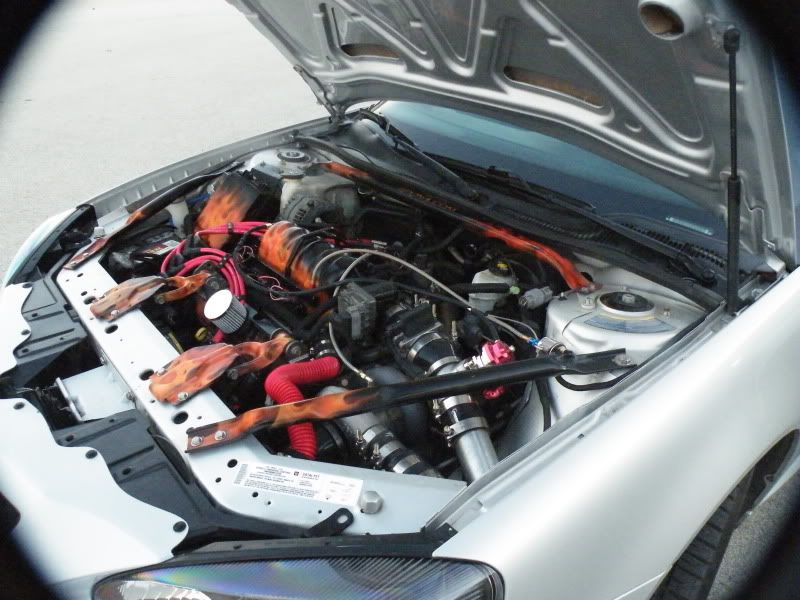

Got the car fired up today. Seems to idle smooth, but got a lot of misfires on #2. I will be swapping wires, checking plug, and checking injector connection tomorrow. Hopefully have it buttoned up enough for short drive tomorrow.
More pics when I get everything straight.

if ur cammed also u may see miss fires at idle
No cam as of yet, just 1.84 roller rockers. I did read that alot of 3800 turbo guys have some misfires at idle due to the plugs and gap. I imagine that would end up being on all cylinders rather than my problem of one cylinder though.

I think that 3800s are prone to misfires. I’m always recording a few at startup on both of my 3800 cars.

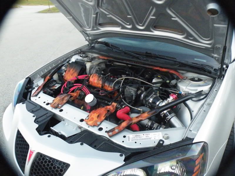

I drove it home today from the shop and have it about 1/2 the beans to 8psi and it is a different car. I can tell already it will break loose in second on the street tires if I push on it too hard :slight_smile:
Just need to work on some bugs and get everything ironed out.

yeah it will take some time to get everything going good. if you can’t find the source of the miss just start swapping shit around and see if it moves. you may just have a weak coil or something

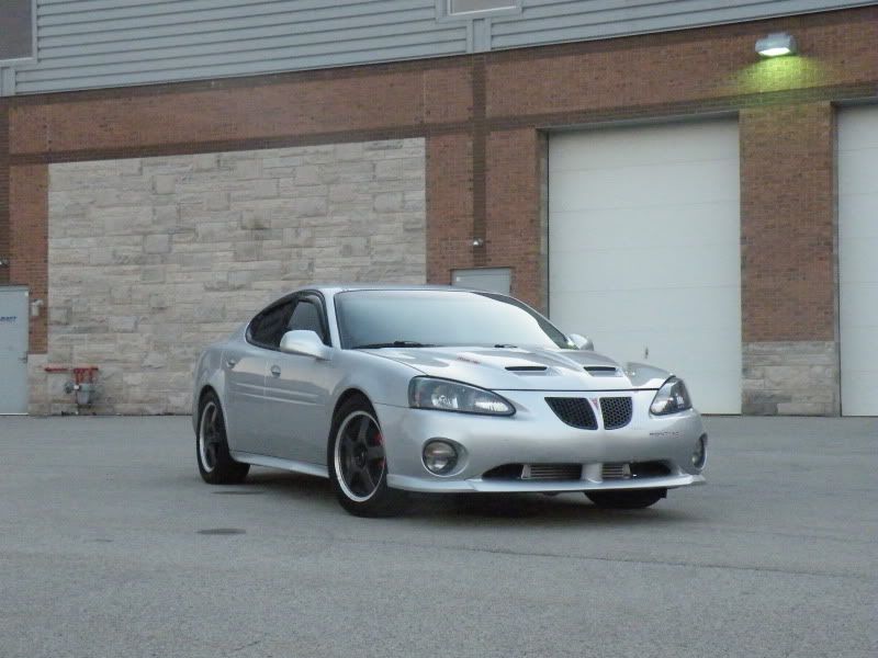

Looking gooood David
Car felt good, got lots of compliments this weekend.
lookin good.
looking real good with that front mount!
<— jealous, maybe if i got a real job i could afford something like that :bigok:
x2 car looks really good !
bad ass man…looks great
