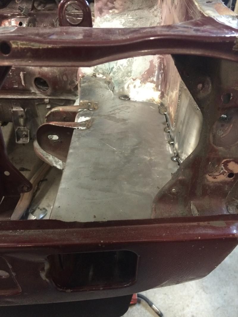

Got a little work done over the weekend. Filled another 8-10 holes and started welding the shock tower seams and the pass side motor mount.
Tonight I got the plates for the motor mounts cut out and one tacked in place, and ground some of the pass mount welds down.

Just an idea, plate the top of the frame rails. Looks nice. We did it on my buddies mk1 pickup. Cut the pinch down, weld the seam back together, and make plate to fit.
That has been on and off of my todo list for years now. Ive been avoiding it, but at this point I may as well do it. Its not like Im in any hurry to get this thing done and it does look SOOO much nicer.
