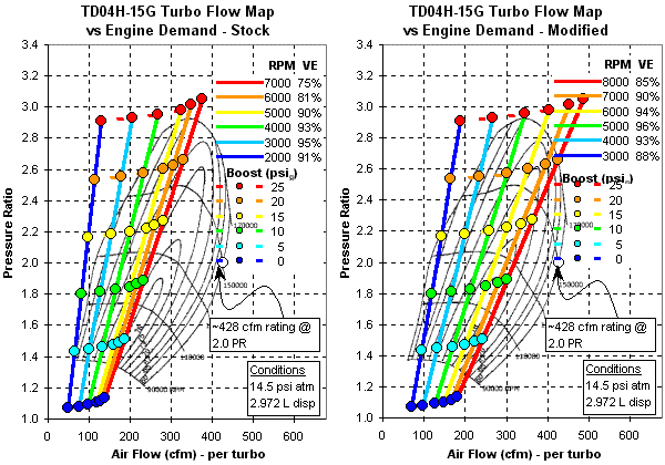

Choose the turbocharger that has a map that’s best suited for your setup and intended driving parameters. Don’t buy based on what everyone else runs or what they think. Have you actually plotted the maps of these compressors against your intended setup? If not I highly suggest you do as a properly match turbocharger makes night and day differences in performance. If you haven’t and don’t know how I can do it maybe later tonight and give you a dead nuts answer. I need to know what your intended engine redline is…
Thank you for doing what I should have done.
Here’s what he is talking about:

I have already made my decision on the turbo and done alot of research on my set up. I was really just bench racing with ya as I dont have the coin to build this tomorrow.
