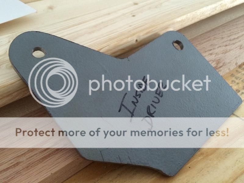

What did you use to cut the steel?
I used my metal bandsaw and then cleaned up the edges with my CNC mill.
I was going to get them water-jet cut but I figured I have the tools, I might as well make them myself.
nice! I keep wanting to make stuff like that but can’t seem to figure out what tools I would need.

I was using a 24 tpi blade to cut the 3mm plate, it took a bit but ended up with a cleaner cut. The rule is 3 teeth for every inch, but I found that as long as I go slower, I can get away with it.
The mill makes life so much easier though, I made these in CAD first, so all I had to do was import it to MasterCAM, set up a profiling operation and it used the bolt holes as origin points.

On point.
I would have made them on my CNC plasma table at work in 3min. :slight_smile:
@Motocrossx23
You know, I have a plasma cutter in my welding lab, I was looking into purchasing a CNC table for it next year, but I don’t have enough room :frowning:
We have a messer and esab table that each will run two heads at once. Makes larger productions runs a snap.
I was looking at the Torchmate tables, they come in various sizes. I just can’t justify losing so much room for a tool that might only be used 4-5 times a year.
