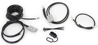

^ I’d probably just build that myself, but it gives you an idea of what you need.

We ran a seperate 4 or 2 ga wire from the battery to the back of my dad’s truck for this purpose. But we used a seperate connector dedicated to the winch on the trailor that’s only plugged in when we’re using the winch just due to the current draw (depending on the size of your winch of course).
I’d say look at what the current rating on that connector is; then what’s the “max” draw on the winch; that’ll tell you if you’re safe or not.

i think im going to run a separate connection for what i want done, just like jays linked.
