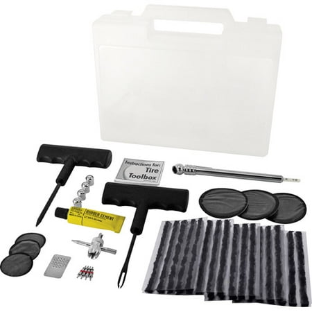

Assuming the nails were in the tread just go to walmart, buy a tire plug kit, and fix it yourself. If it was the sidewall the tire is trashed.
It takes more time to jack the car up and pull the tire than it does to make the repair. You pull the nail, run the rasp through the hole a few times, then stick a plug in with the included tool. Trim the plug off flush with the tread and re-inflate.

Thanks I never even thought of using a kit. It’s only a few dollars more to have it done at a shop but maybe I’ll give it a try this weekend. The larger of the two nails is right in the middle of the tread. However the smaller one is very close to the sidewall, it’s coming out right around the outer edge of the tire. I think I’ll bring it by a shop this afternoon just to get their opinion of it and if they think it can be saved then I’ll patch it over the weekend and see if it goes flat again before Monday.

It’s a few dollars more to have it done at a shop, but it’s much more time wasted and the next time you’ll be paying all over again. Buy the kit and you can fix tires yourself for free for a long time, and when you eventually run out of plugs you can buy just the plugs.
Spending money on tools that let you fix something yourself is always a good investment over paying a shop to do it, especially when it’s a simple job.

Are any of the tools in that kit intended for pulling nails out or would needle nose pliers do the job?

I’ve always just pulled them out with a pair of vice grips. What ever went into the tire came in from the outside so it will come back out that way too.
I’ve always used the patch/plug combo. (take the tire off the rim) They work very well, wile it does take a LOT longer to have a shop do it, its a very good seal.

The place you bought the tires from will usually plug them for free. A patch requires dismounting the tire. Otherwise plugging will cost around $15 and you might as well buy the kit, it is super easy.
