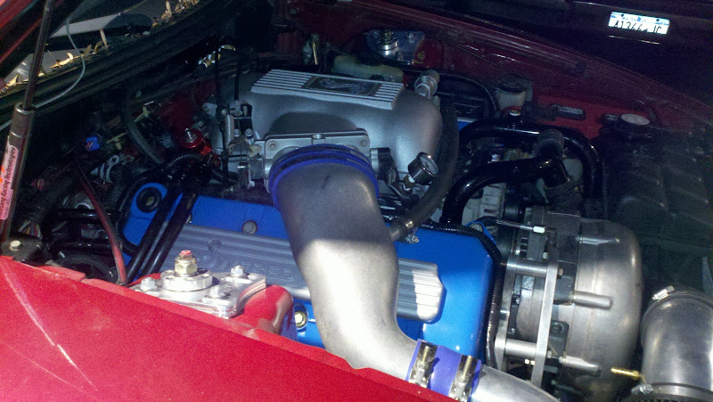

got the motor in tonight. worked 8-6 today, came home and got right to it. took off of work tomorrow so i can get the tranny, ds, exhaust crap in. then its wiring, fluids, and firing it up.
Looking good man. I will have to check this out sometime when I am in Roch.

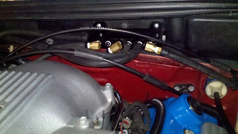

got everything done today, except for firing it up. and my pcv setup, ha. it started getting cold so i cleaned everything up, and ill keep having at it tomorrow. here is where it sits.
vacuum manifold:
is it warm enough up there to take this out still?
Was like 60* today. I drove my FD a few times this past week.
60’s through Wednesday. Probably will hit 70 on Wednesday in Syracuse. Bikes were everywhere this weekend.
don’t worry, he won’t
Lookin real good.
Shame it’ll be snowing soon.
