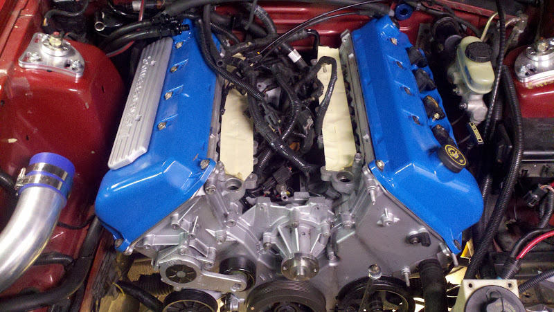

i took off work today so i woke up at like 2pm and decided to finally quit sulking. got everything ready to pull off the crank pulley and front cover. actually kinda lots of room in there with everything off.

holy freakin crap. pulled the head tonight, doesnt look like the valves are bent! i cant see any signs of contact, and all the keepers are seated and everything. best freakin case scenario. although the head is kinda fubar’d cause the tensioner was all over the place on it. i asked a few different people about it, they all said definitely contact was made. im rocking stock cams, i think theyre .400 lift, and -13cc pistons, i guess thats enough for ptv clearance. stock pistons are either -6 or -3cc. super freakin duper excited.
head damage, notice how the one hole is egg shaped. gunna take the head to my machine shop tomorrow to get it fixed.

just poured alcohol down the intake runners, no leaks! no bent valves!

head is fixed. gunna try and get the car running by next weekend.
Helicoil ftw! Did they have measurements of the hole locations or are you hoping there is enough slop in the holes so it all lines up correctly?

i gave em a replacement tensioner to make sure everything was where it’s supposed to be. drained the oil into a paint can filter to make sure there wasnt a whole buncha crap in it. it was pretty clean! not very much poop on my magnetic drain plug either. i thought there would be with what happened, im sure its already embedded into my bearings, ha. weather is supposed to BLOW the next few days so ill try and drive it enough to put some solid miles on it and seat them rings. drove the car about 15 miles tonight, no ticks, solid oil pressure, and still very happy with the cal. working my way up to some higher rpm/load pulls. get some vids up asap, this freakin tial blow off valve on a centri sounds ridiculous!
