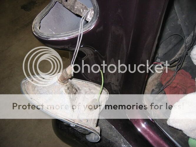

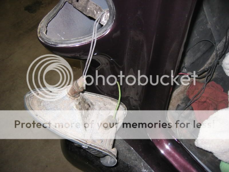

What’s left? Need to figure out why the elec. fan turns on right away, and why the brand new alternator is moaning. Also, the wiring in this car mucst have been done by a third grader…here’s an example of what needs to be remedied, and the reason why there were no reverse lights:
Seriously, why is there a cut wire??? WTF…
