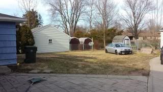

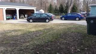

Id like to add some room for parking. I was wondering what are my best options. Price is a big factor as id like to do this on the cheap.Id like to extend my driveway from the edge of my garage to the edge of the house. its about 500 sq feet give or take as it is an odd shape.
I want to do this as cheap as possible but not fall apart on me.I think blacktop is way to expensive .Someone mentioned using the patio type bricks? I have them between my driveway and sidewalk and they hold up well.You can see them in first picI would need stone and digging i believe still.
Here is a pic of where i want done
http://i5.photobucket.com/albums/y170/angryhero46/20140406_174403_zps50d763cb.jpg
http://i5.photobucket.com/albums/y170/angryhero46/20140406_174423_zpsd52ddb4b.jpg

Using pavers will probably cost more than blacktop
Any “paver” product will need a deep sub base and sand over top before pavers. Blacktop will not last as long as concrete and isn’t that much cheaper these days. I believe you can buy bags of cold patch and do the end of your driveway yourself. There really isn’t a “cheap” paving solution. If there was, the inventor would be silly rich. My opinion, go concrete. I can recommend the guy who did my driveway.
^ This. The only way to do pavers cheap is to skimp on the base at which point they’ve never hold up to the weight of vehicles when the ground gets soggy.
What about a compacted fine stone? We used that to cover a corner where trucks kept running over grass at my old warehouse and it held up well.
End of the driveway: Bust out the old with a rented buster and rent a home depot dump to haul it to swift river / united materials. Then pour new concrete. (won’t be bad if the current already has proper base stone)
Top of the driveway: pavers are decorative. Using them for a drive is like paying someone at a factory to make you a 1000 tiny driveways, then paying someone to shop them all to you without fucking them up and THEN crawling around on your knees to install them because you hate youself.
Concrete is a much better plan.
Crush and run stone, and old blacktop tailings. Cheapest way.
