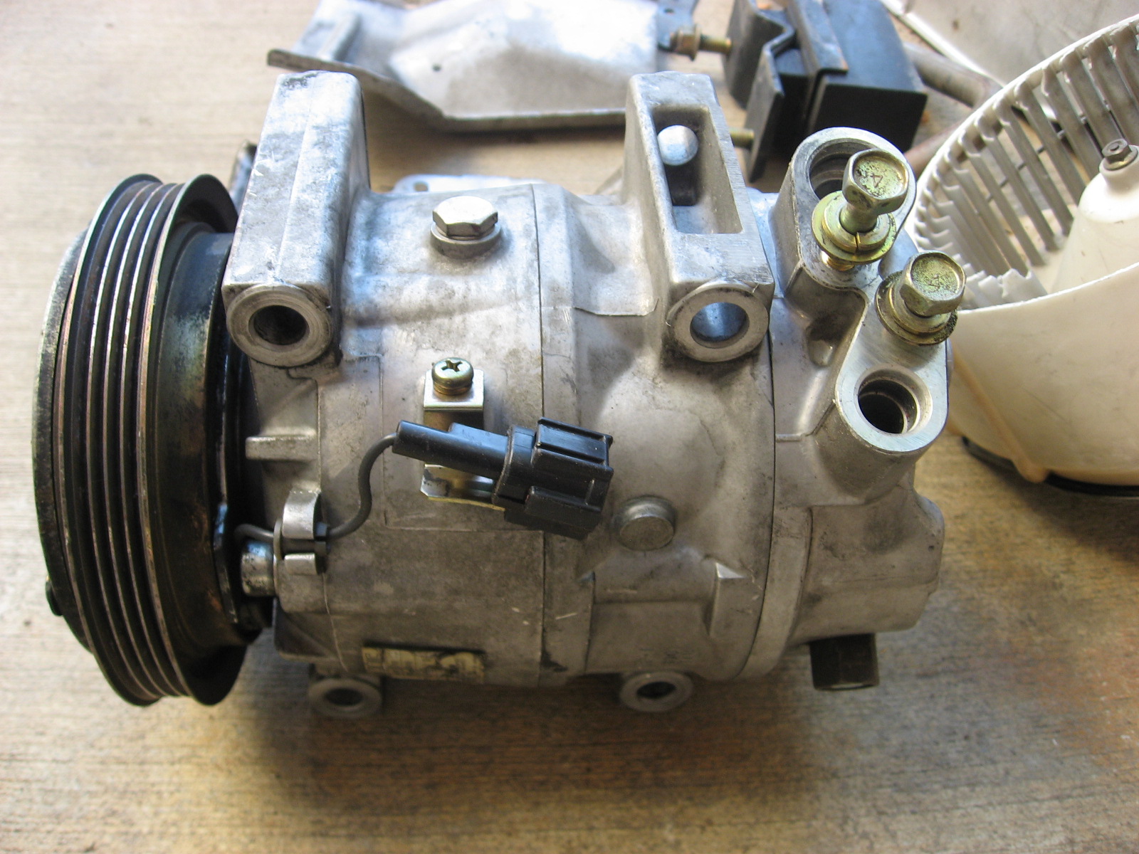

k I have no idea about anything in the air conditioning system. What does the compressor look like.
I know theres a black canister close to where the maf sensor is, has tons of hoses going to and from it.
Then theres a sliver thing on the other side. Its like coned shape. has 2 metal hoses.
Then there is the other radiator thing, I unbolted 1 metal pipe going to the radiator. nothing leaked out… good sign? my a/c hasn’t worked since I bought the car (2 years ago) so maybe it has no fluid in the system, I dunno

u said u unbolted 1 metal pipe… than there should be nothing left… if u still want to double check with my step… but i now doubt anything is in there… the compressor is bolted to ur motor… the line coming from the AC radiator thingy(driver side) goes down, discount that from the big block thingy with the pulley on it…there should also be the lower pressure line, coming from your firewall, that also goes around the engine and down to the compressor…
so hopefully your able to find it now
to better your search… this is a compressor:
located at the bottom front driverside of your motor… u probably unbolted it off the motor when pulling it…
their will be a ac condenser in front of the rad i believe…and a metal canaster near the battery…just follor the lines off the compressor posted ^^ and then removed everything along the way
Ok, So I found a guide  haha. Im guessing those 2 bolts at the top of the condenser in the pic you showed are the lines that you were taking about?
