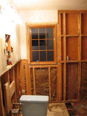

http://lh3.ggpht.com/_H6OF0iQPPIQ/SF7g5VxTM-I/AAAAAAAAGEU/-uYs0peqiTs/s400/day1%20003%20%28Small%29.jpg

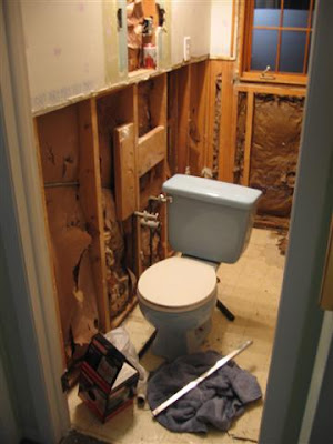

Walls down to studs
http://lh6.ggpht.com/_H6OF0iQPPIQ/SF7g6WYizvI/AAAAAAAAGE4/_K30Np_cg0E/s400/day1%20006%20%28Small%29.jpg
Floor under the tub was shot

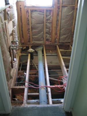

Day 2:
http://lh6.ggpht.com/_H6OF0iQPPIQ/SF7g6vJJvlI/AAAAAAAAGFE/2jzQd2MI_Rw/s400/day2%20001%20%28Small%29.jpg
Floor is out (4 layers of linoleum later!), new insulation in the walls

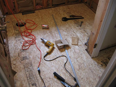

http://lh3.ggpht.com/_H6OF0iQPPIQ/SF7g9Mlkb-I/AAAAAAAAGGA/AZGTYynHy0o/s400/day3%20001%20%28Small%29.jpg
New floor

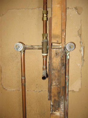

http://lh6.ggpht.com/_H6OF0iQPPIQ/SF7g9ok1UtI/AAAAAAAAGGM/gg-_Mcr2cYU/s400/day3%20002%20%28Small%29.jpg

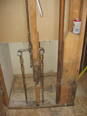

Old tub plumbing (has to move up for the new taller tub)
http://lh5.ggpht.com/_H6OF0iQPPIQ/SF7g-aZRLII/AAAAAAAAGGk/CUWKcPL2rqg/s400/day3%20004%20%28Small%29.jpg
Quick connect plumbing FTW!

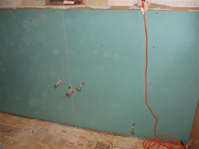

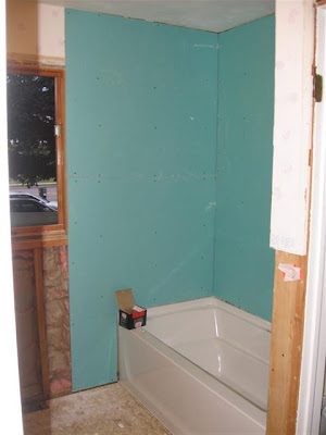

http://lh4.ggpht.com/_H6OF0iQPPIQ/SF7g9xY6BVI/AAAAAAAAGGY/Q-uW0vVlXOE/s400/day3%20003%20%28Small%29.jpg

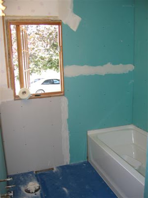

New drywall going up
http://lh3.ggpht.com/_H6OF0iQPPIQ/SF7g-_FhkZI/AAAAAAAAGG8/HNT_5mBpkTI/s400/day3%20006%20%28Small%29.jpg
New tub and drywall up

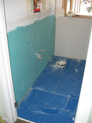

http://lh5.ggpht.com/_H6OF0iQPPIQ/SF7hAor4uEI/AAAAAAAAGHU/yyVG34vlAPw/s400/day4%20001%20%28Small%29.jpg
http://lh4.ggpht.com/_H6OF0iQPPIQ/SF7hA9jOjiI/AAAAAAAAGHg/XTHevsJLWuc/s400/day4%20002%20%28Small%29.jpg

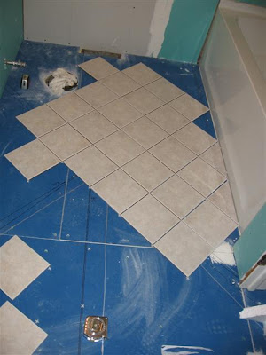

Backerboard is down

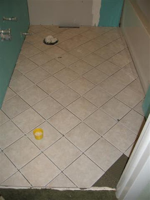

http://lh3.ggpht.com/_H6OF0iQPPIQ/SGBMJhqE5tI/AAAAAAAAGJ4/kbCT8VxpKPI/s400/day5%20%28Small%29.jpg
Started laying out the floor tile

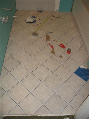

Day 5:
http://lh4.ggpht.com/_H6OF0iQPPIQ/SGGyVHUaknI/AAAAAAAAGNI/-h7hxG3tkg0/s400/day6%20%28Small%29.jpg
All floor tiles cut and laid out
http://lh5.ggpht.com/_H6OF0iQPPIQ/SGMOFB5ZicI/AAAAAAAAGNk/gof429TrCCY/s400/day7%20001%20%28Small%29.jpg
Cemented

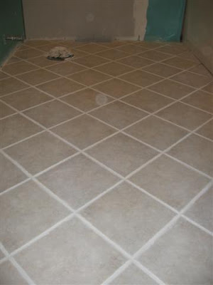

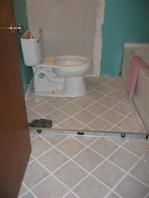

Day 6:
http://lh4.ggpht.com/_H6OF0iQPPIQ/SGRSVht5sBI/AAAAAAAAGPw/2OT1YBNfa4Q/s400/day%208%20005%20%28Small%29.jpg
Grouted
http://lh5.ggpht.com/_H6OF0iQPPIQ/SGRSVz4Bg0I/AAAAAAAAGP8/WYvFom7qMgM/s400/day%208%20006%20%28Small%29.jpg
Finally a toilet!!

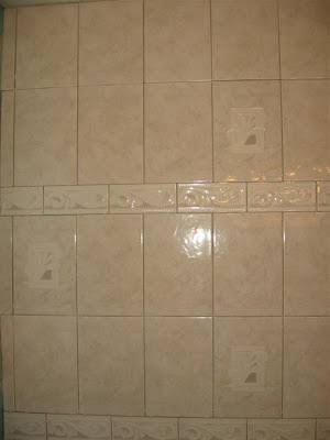

http://lh5.ggpht.com/_H6OF0iQPPIQ/SHAmRbcjHkI/AAAAAAAAGRg/p_WNqBvNHys/s400/tile_wall%20002%20%28Small%29.jpg

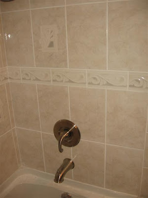

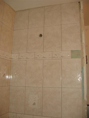

Started the shower tiling
http://lh6.ggpht.com/_H6OF0iQPPIQ/SHGHve8TwII/AAAAAAAAGS8/-pw1B_QXQFc/s400/tile_wall2%20001%20%28Small%29.jpg
http://lh5.ggpht.com/_H6OF0iQPPIQ/SHQBBtiOAkI/AAAAAAAAGUA/9ZSRtHTxv8o/s400/tile_wall3%20002%20%28Small%29.jpg
http://lh3.ggpht.com/_H6OF0iQPPIQ/SHqImjYuCNI/AAAAAAAAGVc/wNb4rc4HOx0/s400/tile_wall5%20002%20%28Small%29.jpg
Fixtures on the shower

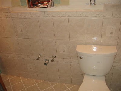

Day 8:

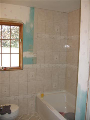

http://lh3.ggpht.com/_H6OF0iQPPIQ/SHv0gZpOkJI/AAAAAAAAGXQ/xnRmG7mxRhw/s400/tile_wall6%20002%20%28Small%29.jpg
Sink wall tiled

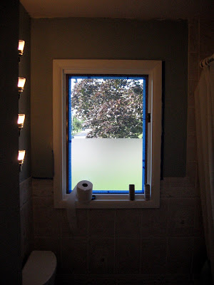

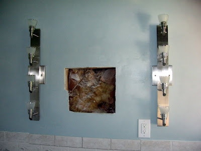

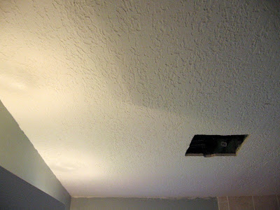

http://lh5.ggpht.com/_H6OF0iQPPIQ/SK3lfMRj-QI/AAAAAAAAKWE/AsAmvP1GnKI/s400/lights_and_paint%20002.jpg
Textured ceiling
Day 9:

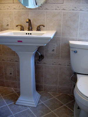

http://lh5.ggpht.com/_H6OF0iQPPIQ/SLILGiyk4XI/AAAAAAAAKY8/csFWviUck7A/s400/sink_and_mirror%20003.jpg
New sink
http://lh3.ggpht.com/_H6OF0iQPPIQ/SK3liMM1ZLI/AAAAAAAAKWQ/cqIOBRz0dMY/s400/lights_and_paint%20003.jpg
New lights
http://lh6.ggpht.com/_H6OF0iQPPIQ/SK3la61J_HI/AAAAAAAAKV4/yb21fXyhvgM/s400/lights_and_paint%20001.jpg
New window frame

Thanks guys. I think for my first attempt at tiling it came out good. a few mistakes, but you really can’t tell unless you know they are there

Looks good, should have used cement board in the shower area though, what you did will work but its just a little better down the road. I had to do the same thing and move all my shit up fr a taller tub,I have the same tub a well. Only thng is that tile looks a little dated to me. Bathrooms are fun though. Looks great.
Looks really nice but it looks like you forgot to put up the vapor block before the drywall. Might get mold issues down the road.
i love the wall to wall tile. very cool
X2 was thinking the same thing, was hoping he did it.
The one thing I would have done different is get a different toilet. I’d get the tank with 2 flush options… one small for the pee and big for the poo… lol
Don’t get all green on me. :bigtdown:
X…
He used paper-packed insulation which replaces the need for a vapor barrier. Do you do bathrooms differently than other places in the house?
I guess it would depend on what kind of paper back insulation he used, but generally they are not very good at blocking water vapor. Not as good as a poly sheet would be with regular batting.
EDIT: I think with the paper backed insulation, you should have stapled the paper to the outside of the studs, not just jam them in there.

ive used those shark quick connect fittings and while I do like them and they make the job easier, I dont think there is a substitute for good old fashion soldering. Imo they should only be used when A) solder wont take, or B) if there is a risk of burning the drywall.
But thats a nice job on the bathroom. I like.
What’s bad about them?
I just personally prefer to sweat pipe, I like to know the joint is going to be rigid and not have any real flex to it. Such as a situation like that I dont think that I would have used them. I would rather save the money just use good old fashion copper for starters. I have used fittings of that nature (at another board members house when I ran new plumbing) and while they do have a chance of leaking (small I know) Id rather have that peace of mind esp, if im burying them in a wall his are in the open and easily accessable if needed. Whos to say that down the road you have to replace something and you wind up jerking the pipe around and cause a small leak, or over time if you have hard water , will the sediment work somehow between the fitting and pipe pushing it slightly away from the pipe and cause a leak? Thats from what I count 8 possible places for it to flex and perhaps have some issue.If you cant sweat pipe No big deal, those are great, but if you can its just the way I would go.
I talked to a couple plumbers about this. They both say that the low flow toilets don’t push enough water down the stack to get the shit to the sewer.
They have been in houses with sewer backups due to this.
Maybe go low-flow in Arizona or Nevada, but here water is cheap. Mine is $9 per month for 2 family house.
The federal government has already regulated toilets and sinks to a certain level, these new green toilets are even less water.

that’s why he used green board, that’s it’s purpose
There’s not really a chance for water to get past the drywall, everything is glued and sealed, and the humidty wont affect anything, because of how the green board is made
