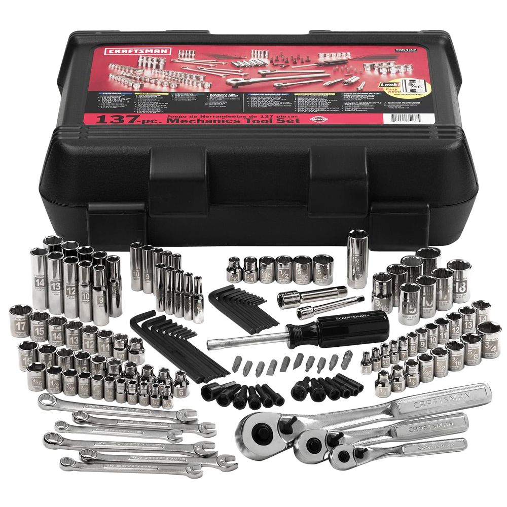

craftsman tool kit, jack, breaker bar for lugs.
thats all you should need.

Elaborate what is in a craftsman tool kit.

Most cars you just need a socket set and a c-clamp (some cars need a caliper piston tool though). On my Subaru for example, I loosen the lugs, jack up the wheel, remove the wheel, and one 12mm socket removes the caliper bolt. Pry out old pads, push the piston back in using a c-clamp and replace with new, and put it back together. 6 bolts, if you include the lugs.
c’mon man. All you’ll need is a socket set, a breaker bar for the lugs on the tires, maybe a clamp or a caliper tool, and some time.
