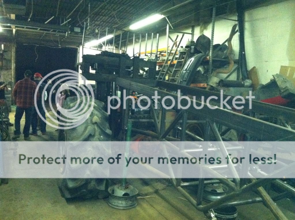

Cut up all the mounts, and got everything mocked up last night. Welded the new wheel centers in an decided, since there was 3 of us and a fork lift… it might be a good time to make sure the tires go on. goin back today to get the last wheel center cut out and weld up the 2 rear centers. Finish welding all the mounts tomorrow after work. I have a couple ideas for motor / tranny an t-case mounts. Hopefully i can get those cut out and get the drive train mocked up this week.

Well it got warm out, And a good friend of mine has had some free time to help me (this shit is to big/heavy to move alone)…so its time to get back to work. All the tires needed tubes, so i got them last week…and managed to get 2 of them pinched in the beads, and are now junk. I gave up and let the pros handle it, dropped them off this morning.
