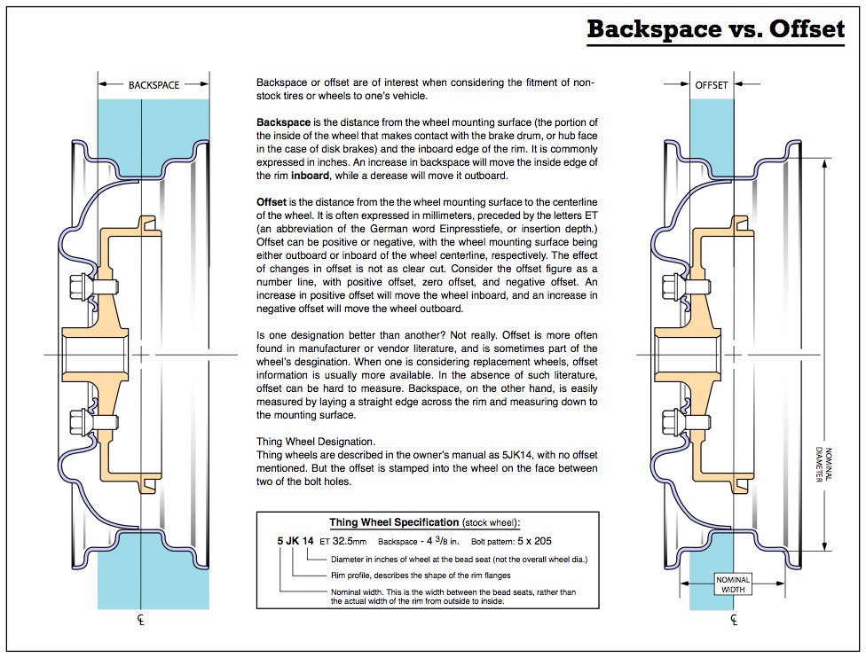

http://img.photobucket.com/albums/v114/jeller/k28dimensions.jpg
diagram form a fellow v dubbers kinesis if this helps you any…

I’m trying to help an older family member buy a set of wheels. He’s looking for a set of 15x7 wheels for a vintage car, and needs a backspacing of 4.25 inches. I was always under the impression that backspacing and offset were directly related, and changing one will change the other. I am aware of what the two measurements are. Most of the wheels we look at have an offset of 6mm, but the wheels he wants have an offset listed as 19mm, as well as a backspacing of 4.25 inches. How is this possible? When I do the math, a 19mm offset on a 7 inch wide wheel should equal a 4.75 inch backspace. Does the wheel manufacturer have an incorrect spec listed, or is it possible to change offset without changing backspacing?
Merged your thread with this one @evilsrt because I think it has some good info.
As for your specific question, it’s too late at night for me to do math, lol.
Thanks, seems pretty black and white to me now. The funny thing is we called the wheel manufacturer and the “tech” we talked to couldn’t explain anything and just read specs off of a computer screen. I think they just have the wrong offset listed. We’ll find out on Tues.
