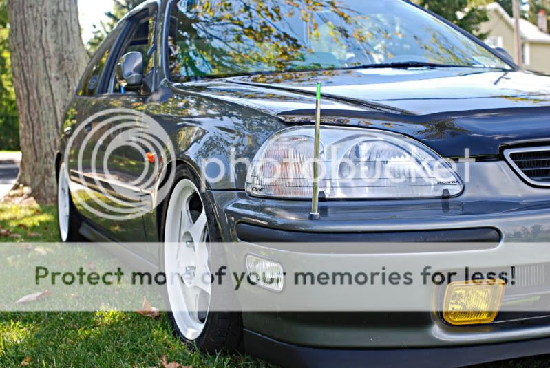

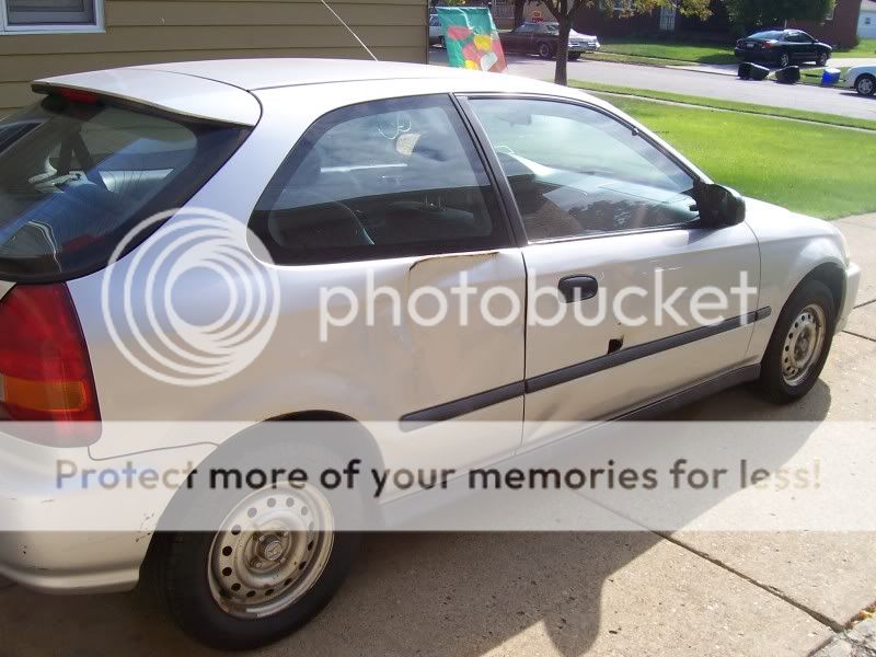

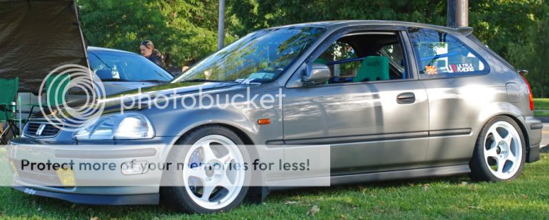

The value of a car shouldn’t matter, if a person has the desire, and will to restore it its worth it to them! I bought my hatch from a member on here back in the day and I restored the complete car basically! The car had a sagging roof, doors were dented, fenders were swapped out for EDM/JDM ones, rear quarters were all rotted out, brake and fuel lines were leaking, etc… I replaced everything with OEM Honda parts and not some cheap knock off sh!t! Roof, rear quarter panels, doors, fenders, front & rear bumpers, brake fuel lines, etc…
This is what it used to look like
To this
So Nick keep up the good work! If you need any help you know I’ll give you a hand. If you do this car right I think it will be one of the best eg sedans around, if not the only one
