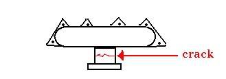

Got home fine… and im trying to figure out. whose fault is this…
I then call the shop and found out he used flux-core to do his welding which isnt too great to hear. my question is, should he be at complete fault?? and if the shop or myself welded it back together and braced the shit out of it… should it be okay?
This is a little pic i made to show an example of the crack…
my final question is, by the looks of the design of the manifold… where would the most stress be on this manifold… i figure its not where it cracked… wouldn’t the tubes going to the head flange let go first?? which leads me to believe my welds are better than a shops that i paid them to do…
