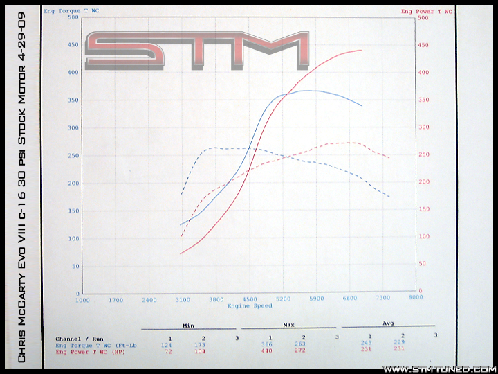

On the dyno we tuned his car to 30 psi on C-16 and saw 440 HP and 366 TQ:
http://www.streettunedmotorsports.com/z/chris_mccarty/mccarty_dyno_sheet.jpg

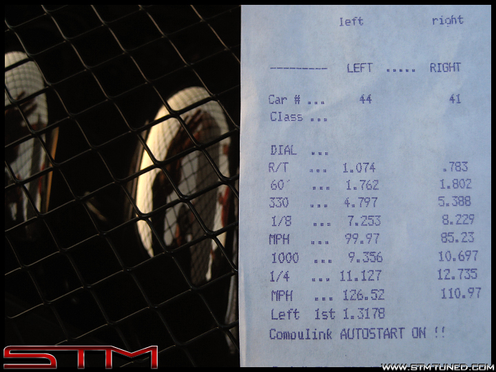

The very next night, we head out to the 1/4 mile track here outside of Rochester at NYIRP.
http://www.streettunedmotorsports.com/z/chris_mccarty/11.1_slip.jpg
With the boost turned down to 27 psi, first pass was an 11.7, second pass we saw the 11.1 @ 126 {thumbup}
Clutch was slipping, tires were spinning and that’s enough to be kicked out on the first time at the track.
