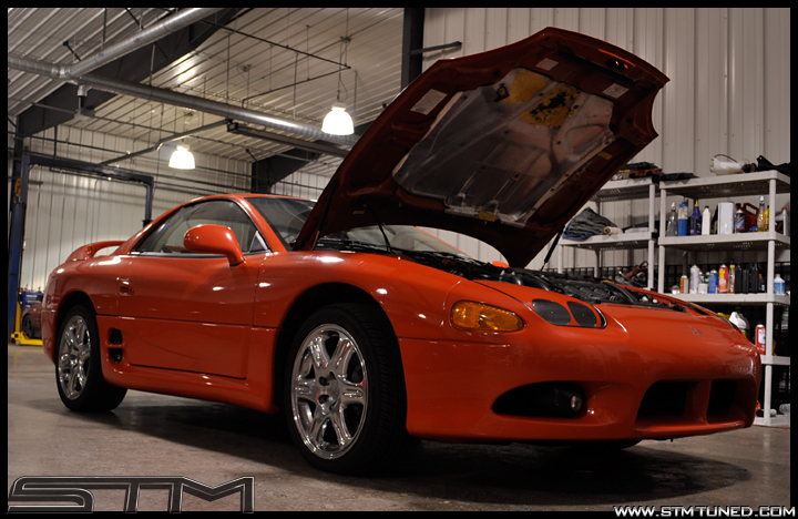

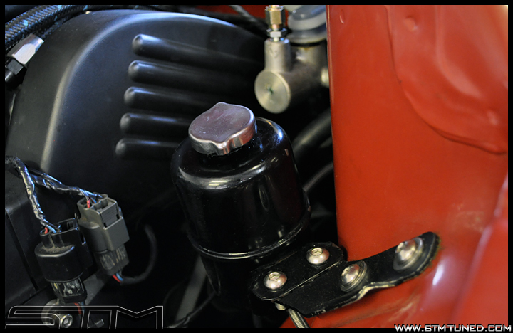

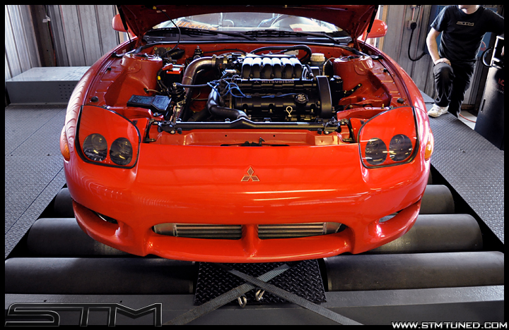

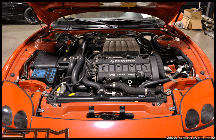

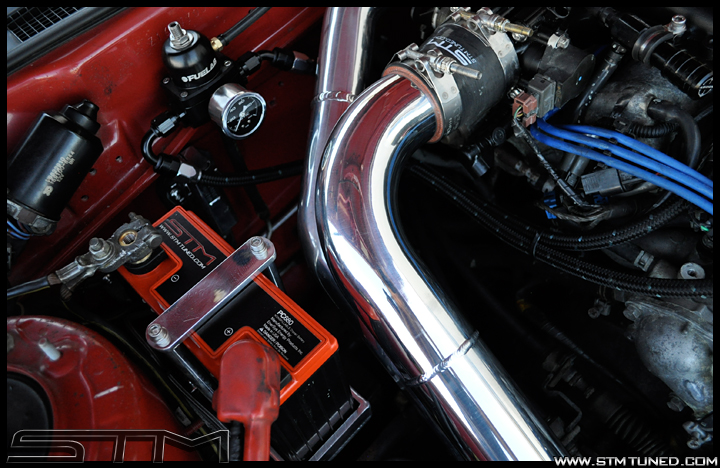

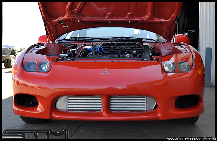

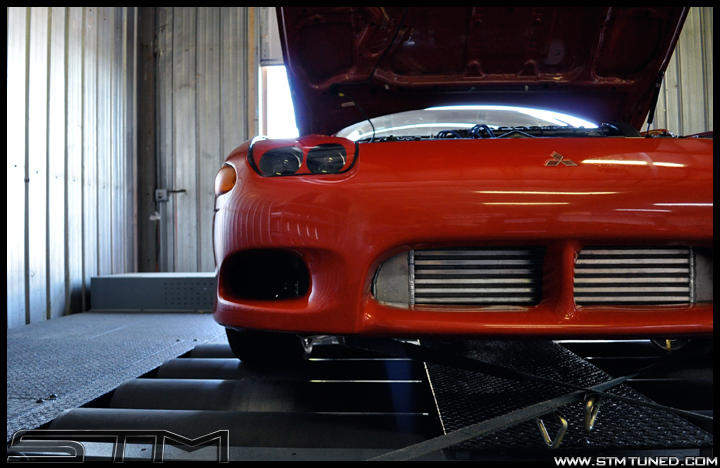

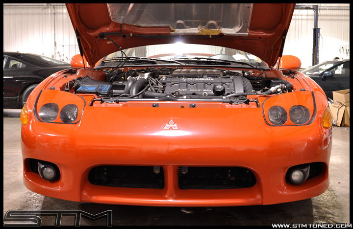

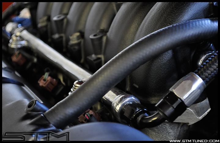

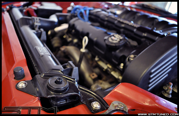

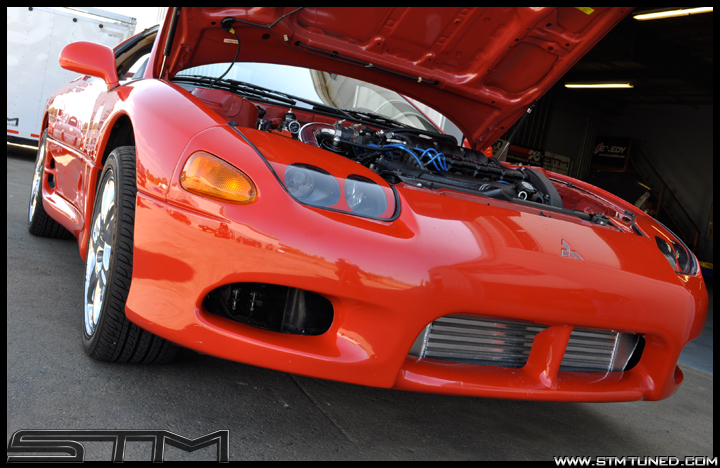

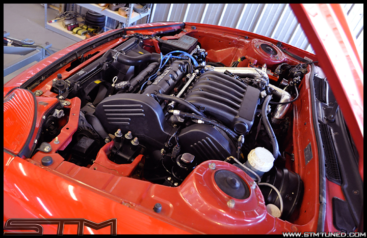

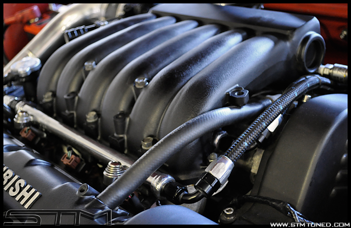

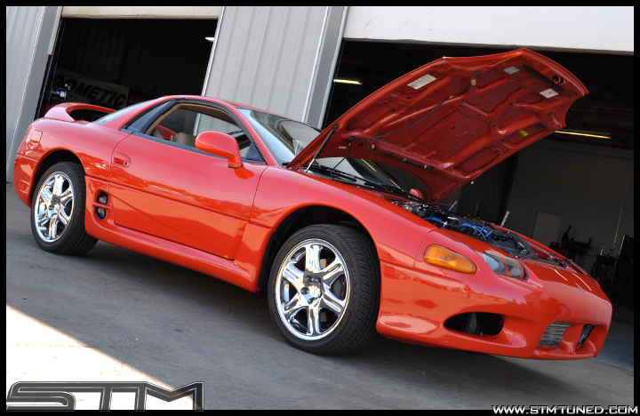

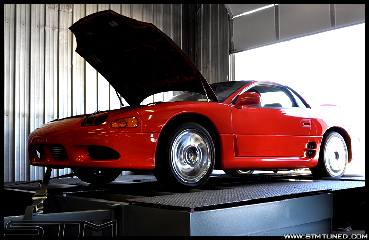

Just finished up Todd’s beautiful 3000 GT. Came in bone stock making roughly 200/200 and finished up at 341HP 413TQ. Here’s a quick mod list:
Stock Motor
Stock Turbos
AEM EMS
E85

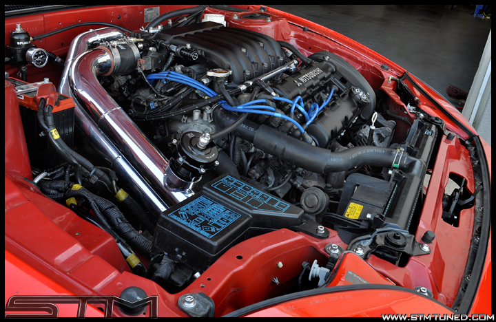

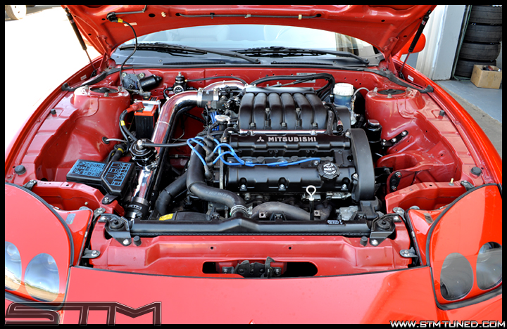

STM Front Mount Intercooler and Piping

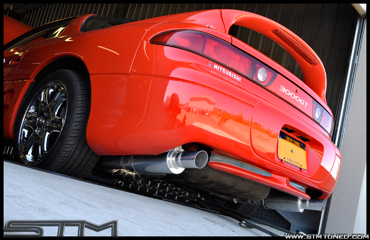

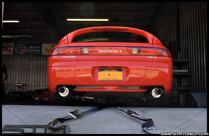

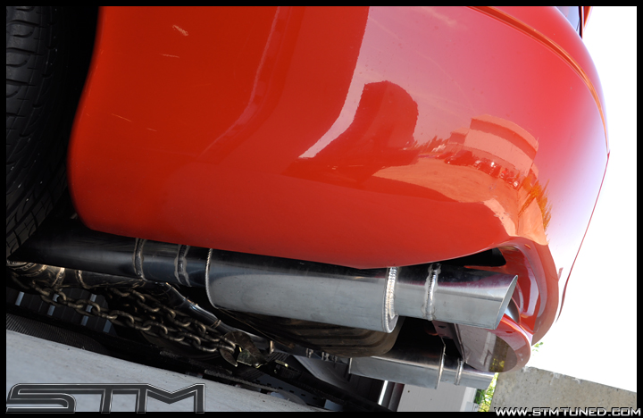

STM 3" Aluminum V-Band Cat-Back Exhaust
STM Small Battery Kit
STM 3S Dual Feed Fuel System w/ Walbro 255
STM 3s ABS Delete Kit
STM Master to Slave Stainless Clutchline
Hallman Pro MBC
TiAL BOV
AEM Digital Wideband, Oil Psi and Coolant Temp
Evo 550 Injectors
Clutch Masters Stage 6 Twin Disc
3SX Rear Steering Delete

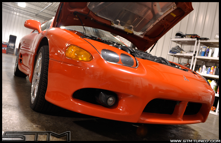

We did a lot of fabricating with this one, along with a general re-vamping of the engine bay, polishing, painting, stainless hardware and so on. The before/after photos tell most of the story there.
Very nice car all around. He does have plans for different wheels and suspension.

sharp!
I always liked VR4’s, this one is a very nice example!
Clean car, those look like a PITA to work on.
the car needs to be lowered badly!!
I miss my 3kgt :frowning: such a gorgeous car.
I like the aluminum exhaust. :tup:
Tell him forget the wheels & suspension right now and go for bigger turbos :tup:
no more fog lights??? throw a smaller set in there if u cant fit them with the new piping
great job guys
Fog lights are unnecessary. I eliminated mine for some nice CF air ducts. Their is probably a similar product for this car.
they look good and provide more lighting
Nice car! Great work :tup:
413 tq! thats awesome
Goodbye transfercase!
no bad power for stock 14b’s how much boost is this car running?
These turbos are 9b’s. The inlet is about the size of a quarter. It was running about 20 psi or so.
-Em
Opps didn’t kno they used 9bs I thought they were 14s but that nit bad at all great job on that project
This is the car that was totaled isn’t it? It’s a shame.
I love it.
Yessir.
