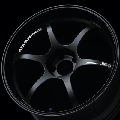

I’ve been looking at wheels for…too long, but I finally found a pair that hasn’t been overdone (at least I haven’t seen many) on an S13. Advan RG-D’s.

http://4.bp.blogspot.com/-aJLmkSkAwUw/Tbkv-wupatI/AAAAAAAAENU/N_f0qylReUs/s400/RG-D_BLACK-1-e1269910649567.jpg
I would think inset/offset is the same thing just worded differently.
If i were you, I’d go 18x10 +35. Throw on a 35 or 30 profile stretched tire and slam it to the ground. Will probably have to do a slight roll on your fenders but shouldn’t be too big a deal.
I like those rims too :stuck_out_tongue:
+35 offset sucks and will hit coilovers on a s13. Even the 17x9+29 will hit coilovers in the front, you’d need s 10mm spacer to clear.
If you want the stretched look and are set on these wheels I’d go 18x9 +25 or 17x9+29 with a 10-20mm spacer up front, and the 18x10 with a 15mm spacer. Or if you feel upto it get the 18x10.5+25, I’m not sure about clearance issues with the size though.
Yeah, dope wheels but shitty offsets.
18x10 +20ish in the rear would be perfect for a daily imo
Sadly, the 18X10 RG-D’s don’t come in +20 ish offset. Only +35…and yeah I figured it will be hitting the coilovers but that can be fixed with spacers and a rolled or over fender’d rear.

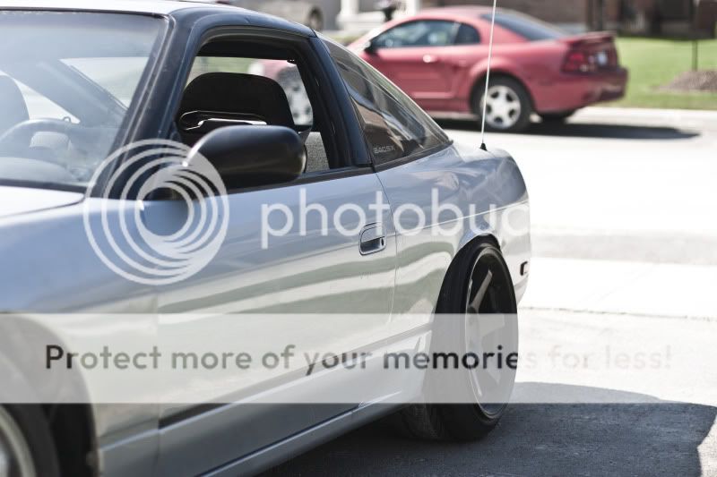

before
after
I m running a 17 x 9.5 +15, in rear, 2.2 degree camber, 235/40 (federal 595, which is technically a 245/40), about the clearance of 3 credit cards. Rolled but no pulled fenders. s13.
With that said, a 17 x 9 +20 on street camber (1.5 degrees) would be flush depending on tire choice. This is assuming u run a slight stretch.
If you run the proper tire for rim, then i have no idea. ahah.
^ I’m running 17x9 +20 with 265/40R17 rear tires (“proper” tire :P), 3 degrees rear camber, stock body with no rubbing issues. Fronts are same rim size with 5mm spacers to clear coils, 235/45R17, ~1.8 degrees camber, stock body no rubbing, and still have fender liners.
your wheels would be sunk with 70mills ciaran i run a 30mm over with .50 camber and it is creditcard fitment, the lower you go makes your lower control arm go on a more aggressive angle which actually shortens and pulls in a more aggressive wheel.
i know that, thats why i posted the picture. but believe it or not the distance from the fender to the lip under load was ~70mm’s
