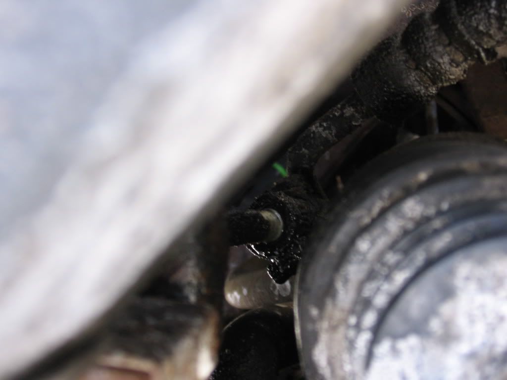

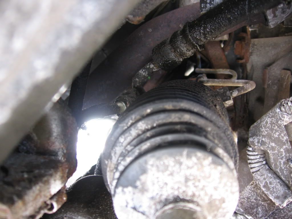

well i got under the car today to examine what had happened and it looks like a hard line has broken off of the steering rack.
I have taken some pics as a better reference:
you can see the clean end of the hard line where it has popped out.
