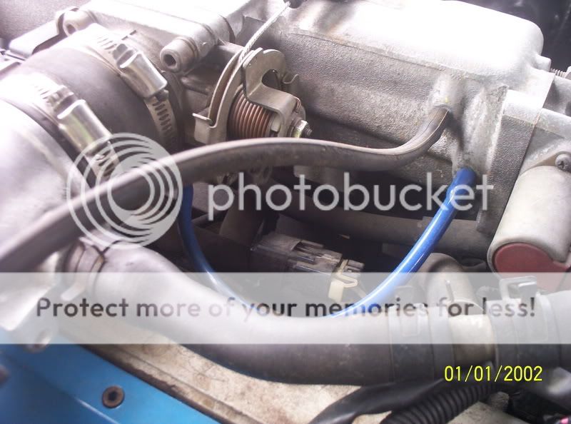

Also, this blue hose is incorrectly hooked up, I’m sure of it, but I have no ide where either line is supposed to lead. The one under the TB spews oil. Anyone who knows this motor in stock form (ahem), if you could please point me in the right direction, that would help.

I believe it goes to the charcoal canister for your fuel vapors. You should have 2 lines going to the canister. One is to control the valve on the canister and the other is to release the gas vapor into your intake.
Your tach wil be off unless you have it modified for the 6 cylinder input, so otherwise you will be all haywire. I’ve heard of some dudes soldering a 10k ohm resistor between pin 7 and pin 45 of the ecu connector (ignition power and tach signal) but I don’t know how well that works.
