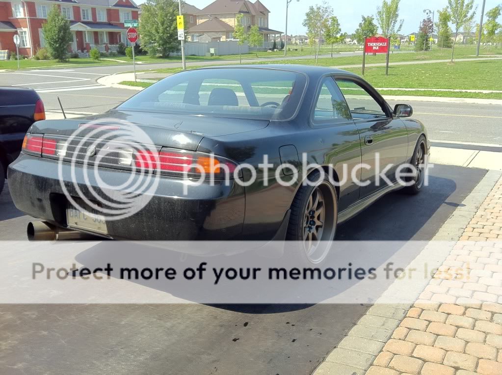

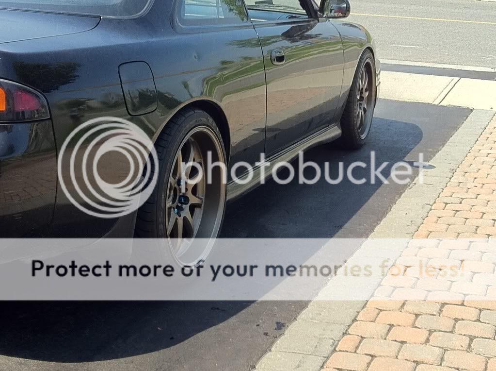

Heres how it sits now, i still need to adjust camber and coils:
I am also thinking of rolling my fenders as well.
sweet ass looking kouki :D, keeping it clean.
did you get the xd9 from samson?
yea got the xd9’s from samson. great guy. I dont know about clean i think its the dirtiest its been in a while.

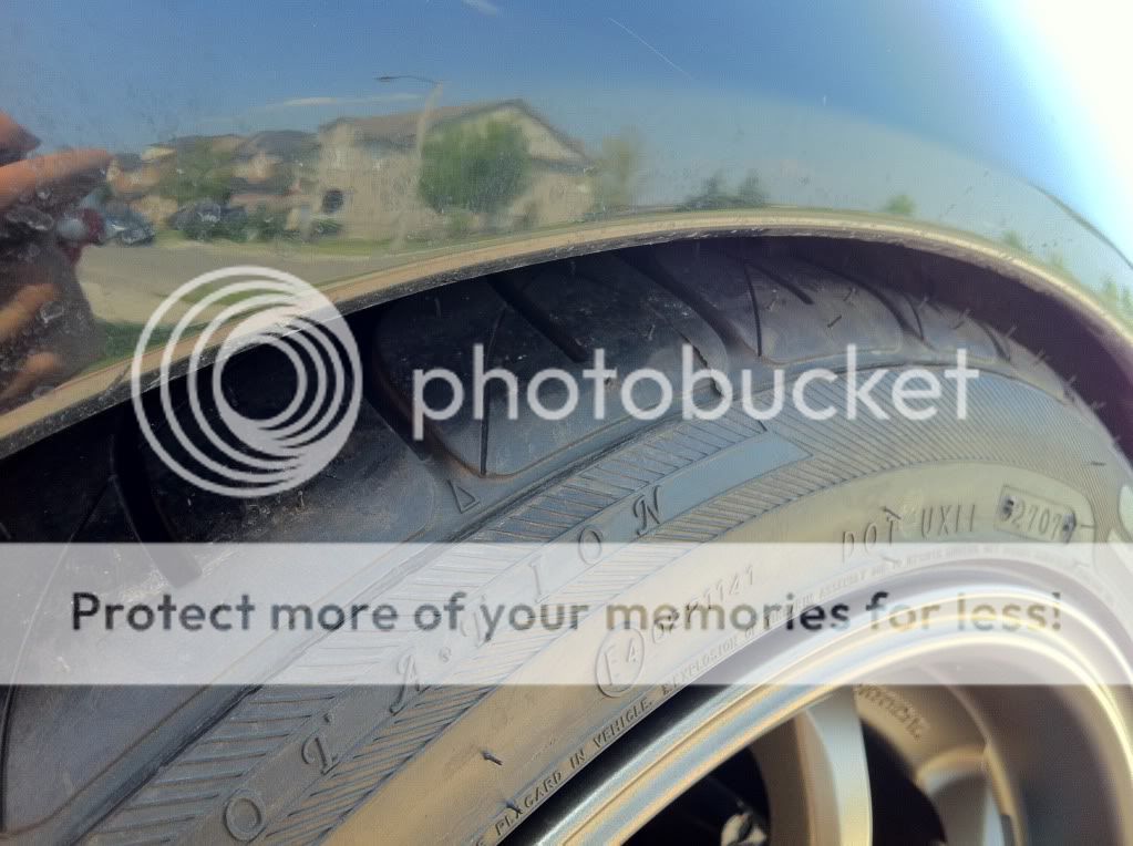

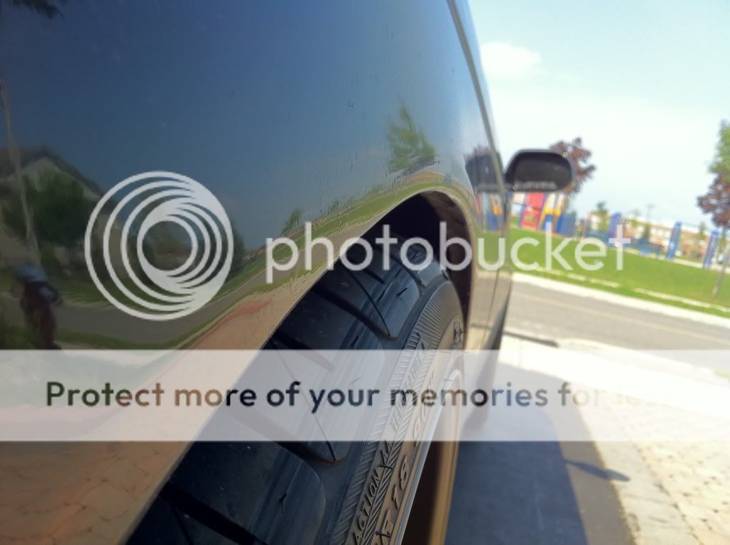

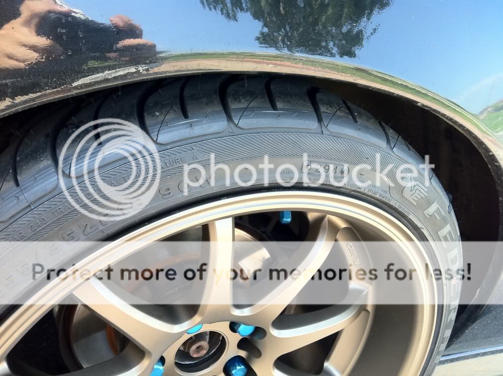

Ok i just rolled and pulled my fenders and didnt damage the paint at all. What u do is get a fender roller (bing rents his ) grab ur trusty heat gun and hold it about 5-6inches away from the fender. Go back and forth till its a littke slightly hotter them warm to the touch and start rolling. Ull have to do this a few times to get what u want but if u need a flare u will need more heat. All in all took me about an hr to do each side. Hope this helps u out.
fender roller with a heat gun is the best method.
Although i did my fronts with a mallet, mostly cuz my front fenders are shit, so i didn’t care.
i just finished doing one of the rears with a heat gun and mallet. turned out okay other then the part that had rust on it. But im not too worried as i said before i needed to get this shit fixed when i get it painted anyways. Ill either try the next side tomorrow or just get it done at a shop cause i think i need a pull too.
