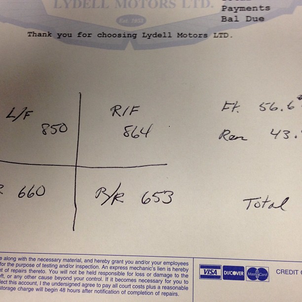

I know people on s2ki were saying they lost some handling when they ls1 swapped their s , saying it would over steer pretty bad since they come stock 51/49 distribution . What’s the ratio on the brz?

53/47

i meant after the LS1 swap… which i assumed is what the image I posted was in reference to.
