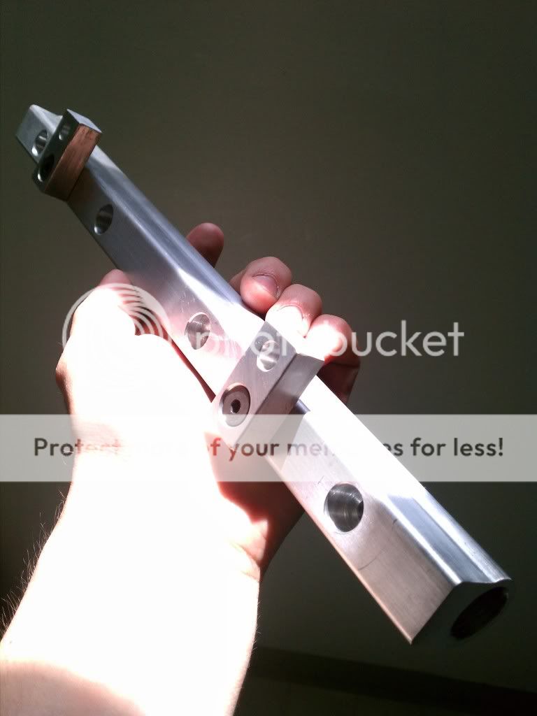

I’m afraid I tapped both ends with 1/2" npt taper. I didn’t know at the time that most were o-ring seals :ham:
Here are a few pics of what I got so far:
I might have just enough room to trim 3/4" off each end and re-tap it for a port seal, but then I’d have to add a counterbore for the o-ring to live in and hope that it compresses the right amount. Pipe threads just seem more straight forward and idiot proof to me.
Those are in the super sweet valved quick connect fittings for the fuel line (overkill, but why not if they’re free from work?)

It’s installed! I used ‘blue monster’ teflon tape. Their tech spec says its good for gas, diesel, jet fuel, etc.:tup:
Yet sadly, I had a leak from a stupid mechanical oversight.:tdown:
The injectors don’t push far enough into the ports to seal properly. A quick trim off the height of the standoffs should seat the injector o-rings right where they need to be.
