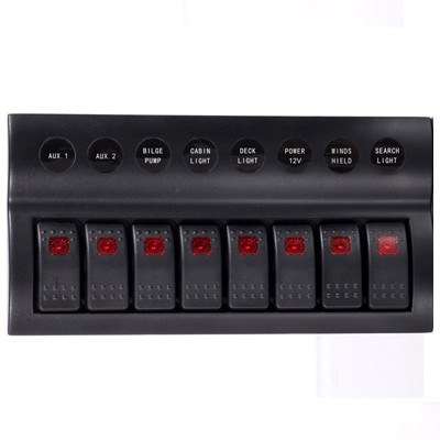

Stuck some stuff back in temporarily. Have a 12 circuit EZ wire kit and a 8 switch LED panel coming this week. Hoping to knock out most of the wiring this coming weekend.

RACE CAR! :slight_smile:
Bilge pump and search light ftw
Haha. Never know when shit will get crazy
Bilge pumps are important, ask me how I know.
I’m picturing mike wiring up about 8 sets of HIDs including in the tail lights and when he hits “search light” they all fire.
This made me lol.
