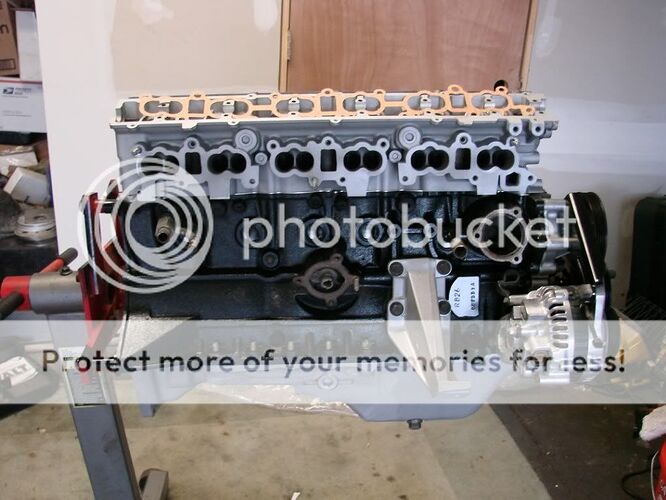

I’m leaning towards loop. This will allow some coolant flow when the thermostat is closed…
What about you guys?

I’m already running a 170. But there is no heater core in the car, so I need to either loop the lines or plug them.

You can see the heater feed/return in this pic:
The return is the nipple on the tstat housing. This is “low pressure”.
The feed is on the block to the left.
The more I think about it, I should loop these, or else the pump will cavitate when the tstat is closed…
Loop.

Plugging it seems like a bad idea. However… How much flow resistance is there in your heater core? I replaced one once before but I never really looked to see how the coolant flowed through it and if it was restricted in some way.
My concern with a clean loop of tubing is that if the resistance is considerably less more coolant will flow through there meaning less going to some other critical path. Easy enough to fix by stepping down the size of the hose enough to mimic the resistance of the core, assuming there is some.
That exactly was my only concern about looping it. Tons of skyline guys do it, though, because their cores always shit out. That doesn’t mean it’s right.
However, i don’t think heater cores provide TOO much resistance.
