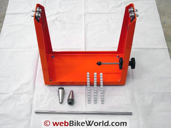

Actually balanceing at home is easy and you use stick on weights. You don’t need one of those expensive balance machines like they use in car places. Both shops I used to deal with just used a basic wheel balancer that looked like this. They balanced the wheels on my 01 ZX-12R and my 05 Vulcan 1600 and I never had an issue. The ZX-12R when I owned it, I had at speeds close to 200 mph on a few occasions due to having a Muzzy Bonneville box (burried the needle at 195 indicated but didn’t have GPS to see what the actual was). Never an issue…
http://www.webbikeworld.com/motorcycle-wheels/balancer/tachyon-wheel-tire-balancer/tachyon-motorcycle-wheel-balancer-kit.jpg
Can you post a link, the picture isn’t working?
Sure scroll down to see the balancer.
Cool thanks alot.
