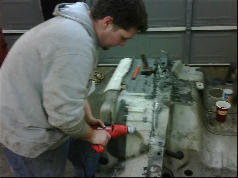

Over the cold months, S13Counterpart and myself have been contemplating the fabrication of a vast array of S chassis items. The first of which to come are replacement S13 frame rails, an ideal project as all R and D comes out of pocket. We began with a stripped 180sx half cut, purchased late January/early February. We then took to removing the frame rails from the half cut by drilling out the spot welds, and removing the desired part.
Drilling the sample rails out
