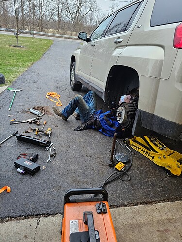

My daughter took her 12 Terrain to a friend and he failed it for a rotted trailng arm mount.
Im not junking a pefectly good car so…
I initially thought there was enough there to just weld it or a add a small plate, but nope. Taking out the bolt broke it to pieces.
Bought a bracket from some guy on the internet and i’m calling it fixed.
I guess i should have started undercoating it 10 years ago. Or at least made my daugher go through the car wash in winter

This is so common that someone makes an off the shelf fix? Damn.
Also, some friend he is, lol.
It seems to happen on most Equinox/Terrain/Vue’s up to 2017 or something.
It’s not a pretty fix, but the bracket is welded between the frame rails and to the floor above, so it seems pretty solid.
The friend is someone I would ask advice, but not really ever let work on my car because I’m cheap and don’t trust any stealership or parts changer. He fails cars all the time for rot, so I’m not surprised.
One was my brother in-laws ford Tauras. He sold it to some guy and that guy still drives it allegedly.
I just did not expect an issue yet. It does not help that mechanics always use the pinch welds and ruin that general area anyway.
