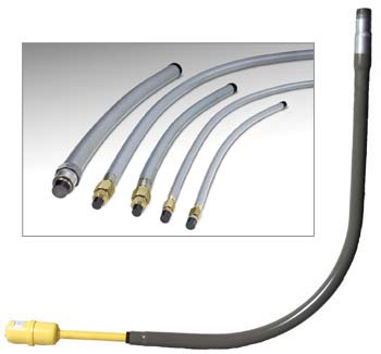

These might be a little over the top for your application, but I know who I’m talking to…
These ends let you run your line inside a sealed steel conduit where it comes up, the rest is plastic, same as the gas company would use. Wrap it in a copper wire at both ends so its traceable if need be.

I did one of these last year, gas line that is. Town of Hamburg inspected. Used plastic approved line buried 18-24" below grade. The riser pipes shown have a slip joint connection at the yellow end. You need a special tool to debur and flare the end for a one time shot at making a gas tight connection when you jam it in. I have some of the line left over, but I’m not sure exactly how much. I can borrow the flaring tool from my plumbing supplier. Otherwise you have to buy one. Town / local codes always supercede state / national code. Hamburg does not allow subgrade iron (black) pipe. I am in Hamburg.
