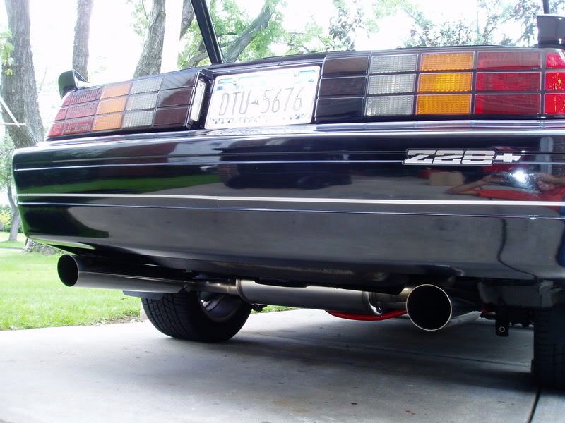

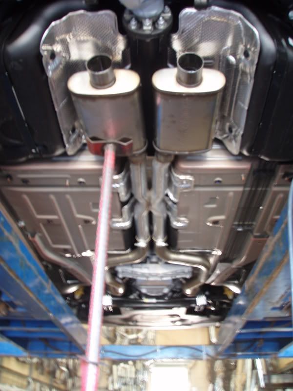

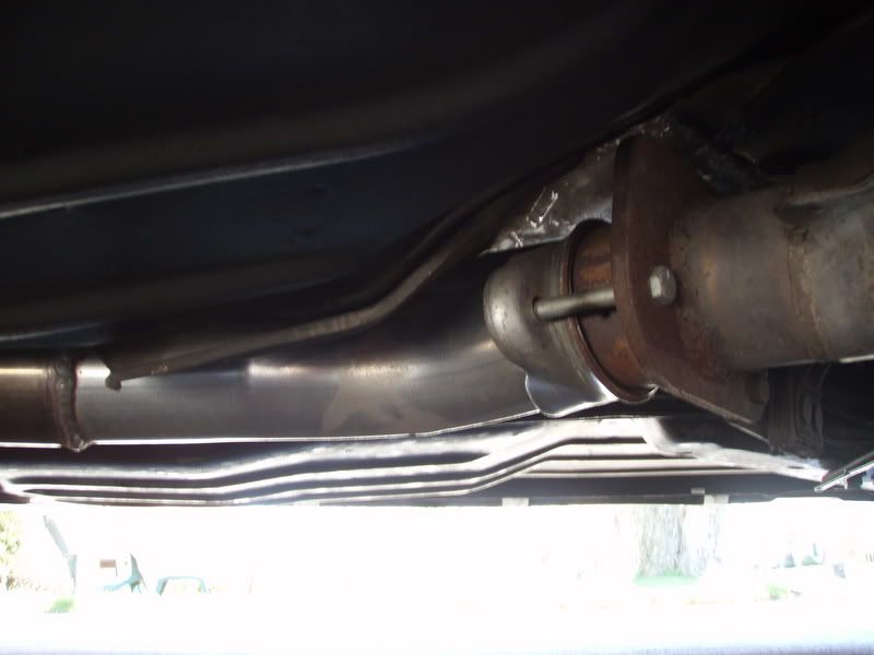

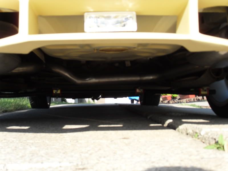

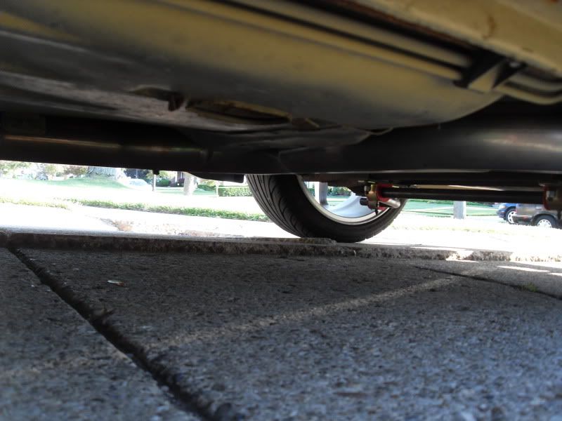

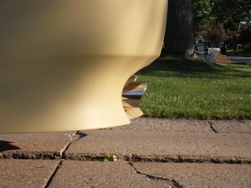

All the exhaust work i had done in the last couple of years, and yes that not even half of it.

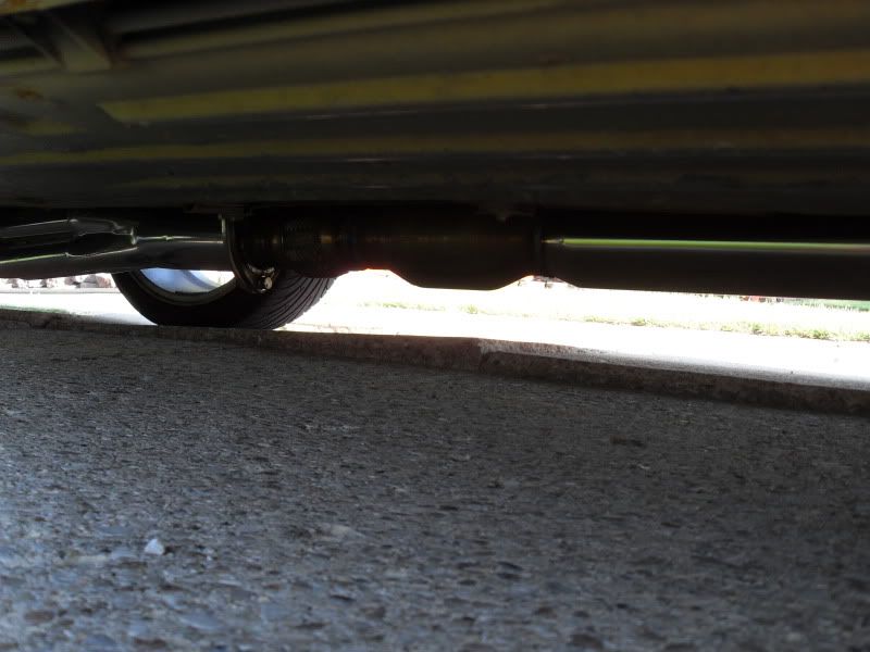

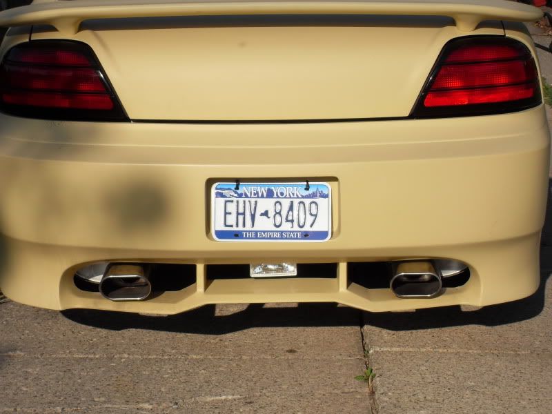

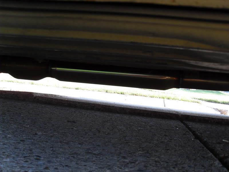

Ok here it is - posted in case if anybody care
On the to do list:
  • CAI - finally got my inner fenders for this :slight_smile:
On the car:
  • Ron’s header - ceramic coated
  • P&P 086 head
  • P&P HO manifold - ceramic coated
  • new timing chain
  • UDP
  • HO ID cover
Exhaust:
  • Ron’s Header
  • Magnaflow CAT - 2.5"
  • Flex - 2.5"
  • Resonator - 2.5"
  • 2.5" piping to the split
  • 2.25" piping from the split to the mufflers
  • 2.5" Borla Mufflers
  • 2.25" tips
  • All stainless steel piping
Pics:
Video:
Daniel Mank uploaded this video to
