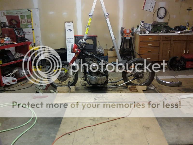

well, jay and myself made some frame changes. Here is what we are stuck with. Id like to thank honda for NOT making there frames symetrical from left and right and making it a huuuge pita to try to convert rigid without lookin goofy and crooked as all fuck.
this is what i will work with. Frame is super close to the chain so ill have to see if it rubs after i get it lengthened.
I still need to add in bracing and brackets and finish welding the frame. This is def not a show bike.lol

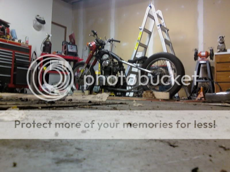

added some braces. final position of seat and rear fender (formely front) is now mounted.

Is it just me or does the new rigid section you welded in look twisted. On the lower portion where you added braces. Sometimes when you weld a frame and it isnt done in a jig it can pull and twist. Perhaps it’s just the picture but it really looks twisted
like i said, cb honda frames are not symetrical from left to right. meaning the right side do to engine alignment is a good 1-2in lower then the left side stock to cradel the engine. so i had to turn up the right side to match the left side so they both had a ending height of 4.25inches right before the angle back up to the rear. so in result the right side has a slight up angle to match thd height of the left side to make it symetrical before i ran it to the rear.
does that make sense? its kind hard to explain.

Wouldnt you be able to cut the frame where it is circled, and then start the split of the frame the section after with fresh pipe to make the frame symetrical? or would this throw off the placement of the motor and such on the frame?
or maybe cut the frame a litte before your new welds, bend the frame to make it symetrical, and the weld in brace plates at the bends
edit: sorry i actually just took the time to read what you said lol, so the problem lies within (idk what its called), where the rear sproket/axle/wheel/hub is held because of the bends of the original frame?
yea, if i were to cut the frame i might as well have built my own frame.
which at this point im not far from. I didnt wanna mess with the frame where the engine mounts because i didnt wanna mess with the sprocket alignments. Not that i couldnt but i have a habbit of everdoing shit and i just wanted to keep this simple. Maybe my next build ill start with my own frame or a bike with a frame to begin with like an old triumph twin.
yea it doesnt really look “goofy” its just because of how it is stretched, im sure you could cover it up somehow if it was that important.
