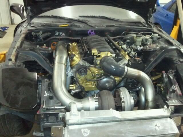

alot of guys run the flex in the ypipe to aid in alignment, however id rather the y pipe be more structual then anything else, and i managed to weld everything up with minimal movement soe fitment is still great at the vbands.
u redid the downpipe after removing the coils, i just wasnt comfirtable leaving them there with the heat. downpipe is done and im ready to start fabbing the exhaust as soon as i get a flex section.

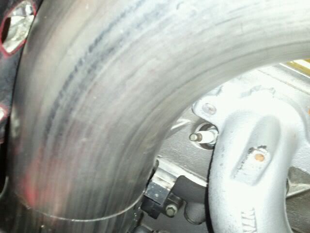

the downpipe was super difficult because of the angle of the rear spark plug and the clearance. lil close to the fire wall but we can always “move” that a lil bit.

I think a flex section would be a good idea in the cross over. The main reason for them on oem setups (other than mfg variation) is that over time thermal expansion and vibration may cause the welds to fail. It will likely be just fine without it too. :shrug:

yes, however the amount of miles and action this thing will see will be minimal compared to what a 100k mile DD so i wasnt too concerned. I matched up the mild manifolds to mild vband halfs and the other halfs are 304 to match the crossover, so hopefully the major thermal expansion and contractions will accur at the vband connection itself. However if there are issues we can always throw something in there.
again, i think thermal coatings are great for show cars that barely see any kinda driving. I hear too many horror stories of flaking and issues with coatings after people spend tons of money. For regidity wrap gets my vote, and its easily replaceable at an affordable price. plus i love the way the lava wrap looks. I think it would look great mixed with the current color scheme.
i dont know how much drew will love the coating after he bumps the downpipe and it chips, because things are super tight in the bay. Ive always liked wrap over coating though. just my personal preference. i think the wrap keeps things cooler, regardless what other people say. Ive got the hotside of my turbo coated and after a couple flash rusts from a year or so of boosting you would never of known it was coated. so now the turbo is wrapped.
Nitroplate is cheap for ceramic, and will warranty their stuff, I’d coat it all, wrap what’s going melt bad things, fitted blanket the turbo and powdercoat all the charge goods. at a minimum coat the manifolds to keep the iron from looking terrible after a week. I do agree wrap is better for heat retention, but coating keeps things pretty…

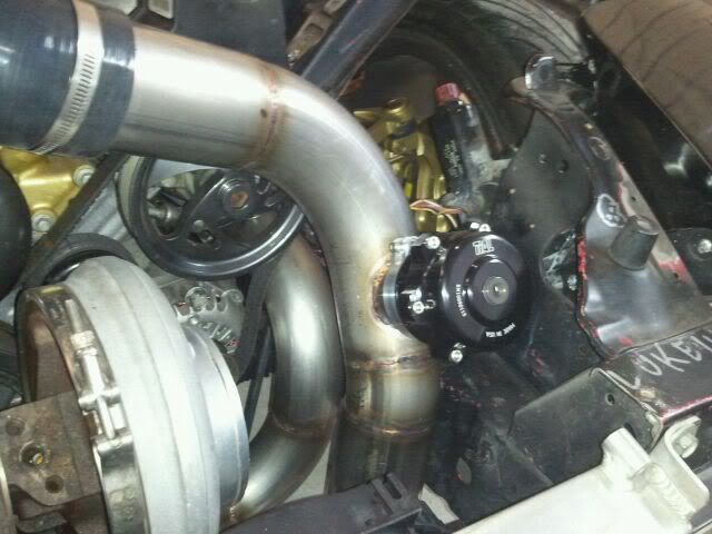

BOV installed
