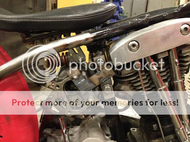

Anyhow, I made up a temporary bracket to locate the turbo. (Ultimately a nice stainless plate will replace the “H”)
And then started doing a little exhaust planning. I’ll be getting a magneto, so that pretty much forces the front pipe to go under the side of the engine. Then i thought I’d merge the two pipes under the transmission area and feed the turbo from there.
It’s pretty simple, and I’m not opposed to something wacky or different, I’d be interested in seeing some other ideas. Here’s a blank sheet:
I think the way you have it mapped out is the only way that makes sense and would be efficient…especially if you want the pipes to be near equal in length. The location of the intake and exhaust ports are really limiting you…where are you planning foot controls to be? Might be able to do something wacky demending on where your legs are located if you consider placing the turbo someplace different
EDIT: I forget, are you running draw-through or blow-through on the carb?
Blow through. Looking to put my feet just above the black circle that’s inline w the crankshaft.
I dont know all the ins and outs here yet, my focus was wacky and different.
i lol’d
I’m certainly no engineer…but I definitely see some opportunity with this design…Provided there is a big loop section for your leg to get to the pegs.
