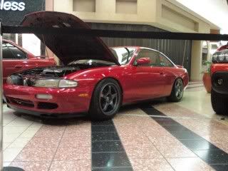

put some new coilovers on(tein super drifts, thanks bing) put some of my z wheels on the front, changed the balljoints and had an alignment done at licatas(thanks jeff)
put my lil engine cover on too

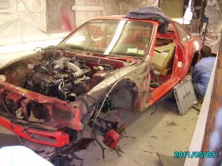

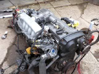

started the tear down
cleaned the engine up

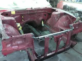

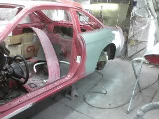

stripped the engine bay and welded in a custom rad support cuz im guna b running a mishy mo mo rad and the factory clutch fan
my good friend spraying it up real nice lik
and bam
LIKE

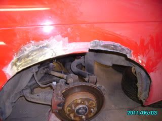

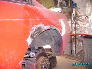

my buddy hooked me up wit sum nice rust repair
I guess all the people telling you to clean it finally got to you. Can’t wait to see if done. Going to be do anymore work to the motor while it’s out?
hahhahaha ppl been tellig me to clean it for years! so for all them its finally celan!!!
no work to the engine, compression is solid, doesnt leak a drop of anything, i did put a new pcv vale and grommet, oem 300zx t/stat, and new spark plugs.

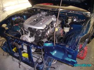

Engine is back in, tein inner and outter tie rods, nismo power brace, mbc, new brake and clutch master, and all new sway links intsalled.
still gotta bleed the brakes and clutch but i’ll do that when the car is done.
tried to tuck most of the engine harness up under the intake mani to clean it up
i still have to mount the rad, fridge, my p.s cooler, plumb in my powered by max coolant swirl tank, and fab up some i/c pipes, guna try n bang most of that shizzy out 2night.
then the enigne bay should b pretty much finished

That color is hot.
Looking good :tup:
the color is bermuda blue pearl, it was a special oder GM color from 06-10 on caddy trucks and chevy avalanche and tahoe.
the pics dont do it justice, cant wait to pull it out in the sun when its all wet sanded n buffed out. it changes from green to blue to teal depending on howu look at the car
:tup:
siqqqqq but i thought u were keeping that shit red, cant wait to see it in person
i was guna keep it red but my buddy talkled me into this color. and i figured if im going thru all the work to paint it might as well switch it up
