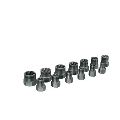

Use a bolt extractor
http://www.matcotools.com/ProductImages/mbx13.jpg
Not an ez-out
http://www.ca-cycleworks.com/shop/catalog/ducati/img/tool_1018.jpg
proper tools > *
/thread
