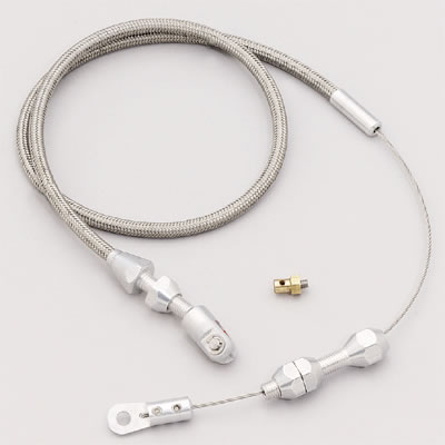

Hopefully your next one works. If not, Summit has a Lokar 24in SS cable. I think that is their shortest one.
http://www.summitracing.com/parts/LOK-TC-1000TP/
http://static.summitracing.com/global/images/prod/large/lok-tc-1000tp.jpg

My lokar 72in TC arrives today. :smiley:
But it’s not about it flopping around. The way a motion control cable works, it should not require support anywhere but the ends. In fact, holding it down will make the binding worse.

Got the LOKAR cable installed, same basic setup.
