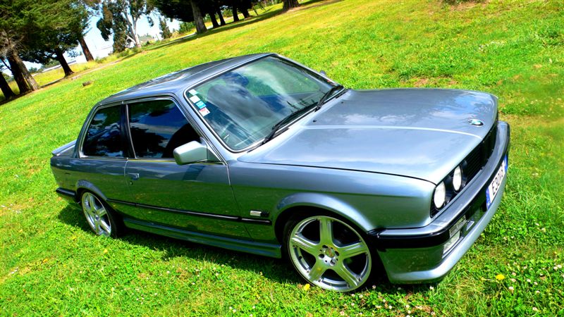

the m tech I body kits were offered only on m tech cars in europe. you can find them around the forums, let me know if you’d like me to look around for one.
be wary on the bmp kit. it fits like shit, and is really wavy. you will also have to modify the rear bumper to fit the early arches i believe. i had bmp sideskirts and got rid of them.

more m technik I pics
this next one shows the star-tac smoked tails and euro plate filler (and a euro plate obv, but the plate filler can be used with U.S. plates)
