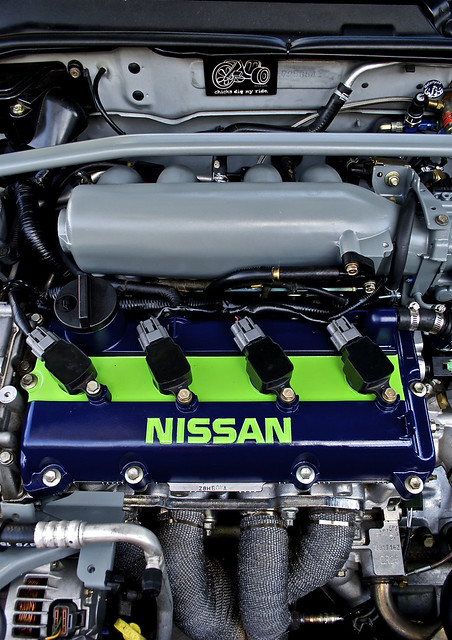

shaved my manifold
before (some sanding started)
http://farm5.static.flickr.com/4099/4903742998_432f3a04fb_z.jpg
runner
http://farm5.static.flickr.com/4117/4903153657_0b4ef555b7_z.jpg
final product
also redid the valvecover along with several other things in the engine bay

Hrmm there’s another modified Silver SE-R around then. Regardless, I like your attention to detail on this!
WOW …bay looks clean…makes me want to bust out the rattle can and zip ties to relocate ish…i am assuming ur battery is in the trunk…where did u run the power wires and anykind of distribution block?
thank you.
thanks
yea i moved the battery to the trunk and placed it in a marine battery box.
i harnessed it down from inside the box using self tapping screws
i got 15ft of 2gauge copper wire from home depot and ran it through the cabin where my amp wiring used to be (under the panels along the left side of the floor)
for a power distributer i just went to best buy and bought a 0-4 gauge in/4-8gauge out power block and tucked it behind the fender
one 6gauge wire went to the starter and the other went to the fusebox
i was thinking of doing something similar…except taking the main cable that comes off the battery now and putting that into a D block and then running the wire form teh trunk to the block…same principle just reusing some existing ish…
problem with that is there is no “main” cable that comes off the battery. if you look closely, the positive terminal actually houses two small (~6gauge) cables that run to the fuse box and the starter. you have to buy a main cable to run, unless you wanna just extend two smaller cables through the cabin, but that just seems like extra work.
