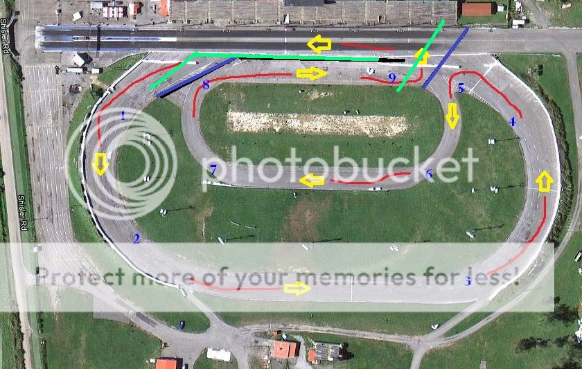

Jeremy / Mike, what do you guys think about this setup? I’m just trying to make it a tad more interesting and utilize the section of the track right in front of the grandstands. That way those sitting in the stands are closer to the action.
The black line is a wall that already exists, the blue lines would be formed by the large foam blocks:

Yeah, we found that out during the drifting last year. But maybe it’s worse? Are those areas avoidable given the course map I posted above or can we modify the course map to avoid those areas?

Used the Nascar turns 1-4…
More runoff room the better Turn 5/9 and Turn 8/1.
Do they still have the movable Styrofoam walls?
Turn 5 I’d say minimum 50 feet of runoff of the “race line” 1st blue Styrofaom wall another 50 feet of “buffer” then Turn 9 green Styrofoam wall.
So in either direction you’d have a minimum of 100 feet of paved runoff before going across track. (150 feet before going of one “raceline” and getting into a second)
Make the entry to Turn 1 wide to give Turn 8 more runoff.
Sure it might not be the highest quality track, nor the best hairpin turn, but it is local and still would be fun.
Of course I missed that the black wall was solid :ham:
Don’t hold up the entire thing for me, I wont be driving or racing anything in it anyways. just sayin im out of town.
You can’t have head on traffic headed at each other with only foam blocks between them.
Can I stand on the inside of the track? lol
I agree, but the speed into the apex of both Turn 5 and Turn 9 would be so slow that 150 feet of paved runoff should be sufficient. The only other thing is squeeze down (with cones) going into both 5 and 9 to reduce entry speed even more.
Until someone has a brake failure, or locks up, and goes straight on after a straight away or higher speed banked oval. It wouldn’t work.

Or we chicane it towards the end with foam blocks (turns 4-5 on your map.)
I think things could be mitigated even more simply by limiting the number of cars on track to 3 or 4 max. If we tech cars like we did at Dunnville and make sure to go out on instructor laps with n00bs that will help too.
The only spot I’d be concerned about are turns 4-5 as mentioned above. The rest of the track isn’t going to be fast due to the size of the inner section and the conditions of the pavement.

This reduces the “heads onsy ness”.
Turn 5 turn Styrofoam wall or cones to make turn in really wide which move runoff away from Turn9. Break in wall to allow runoff into dragstrip
Styrofoam Chicane going into Turn 9 to create a tight slow line, try to get runoff parallel with the Styrofoam wall (not into).
I still can’t make a GREAT argument, because I still can’t get more than 150 feet between the two lines.
I still favor the original “kidney bean” course because it should be smoother, the Turn 9 might be a bottle neck.
