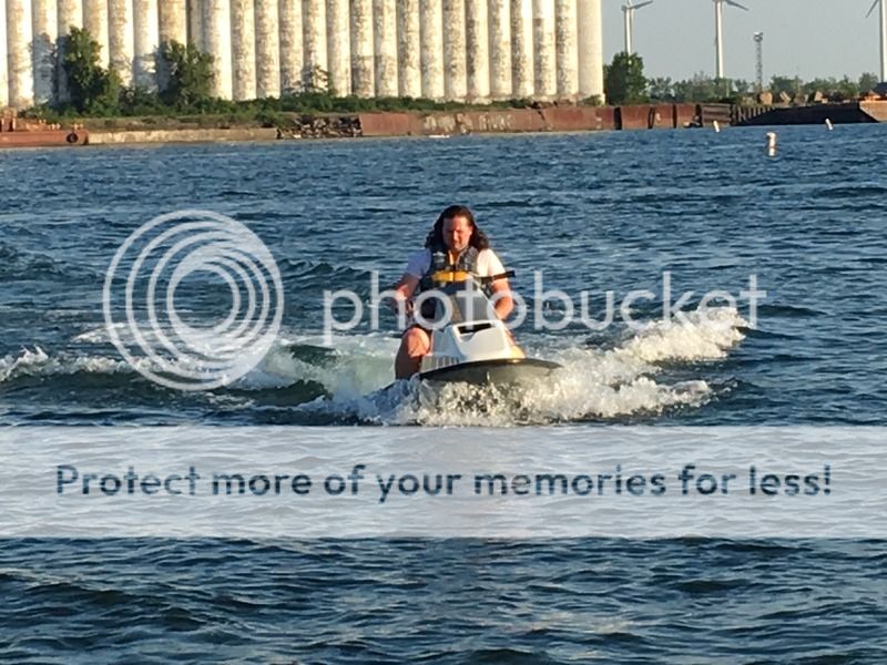

Yea man, it is frustrating…but now I have another nutty theory…
Since it was tuned up (replaced fuel selector valve and adjusted the carb.) at Anchor Marine after last season’s end, and the first time I had it out this year, it ran 100%, consider this…
My machine has a very aggressive hull design, and when running, is at quite an angle in the water…could it be I am not getting fuel from the pick ups in the tank when I get down to say, 1/3 of a tank? Could it be something so simple? I doubt it, but I just filled up after my last ride. It took 4.83 gallons. According to what I could find online, my machine has a tank capacity of 7.7 gallons. Seems unlikely that this could be my issue, but I am chasing for answers at this point…
For reference from standing position to running…and running at even low speed…

Did you rebuild the carbs last year? If you are still running the old grey fuel lines I would check your fuel water separator and make sure it’s clear, then, mikuni marine carbs have small screens in the inlets on each carb and I bet yours are plugged with crap. Even if you cleaned them out last year, if you are still running the stock grey fuel lines they are probably plugged again. fwiw, I’ve ran both of my seadoos on the same plugs all season and I took them out 12-14x. Carrying a spare set with you is never a bad idea however.
My machine has only one carb (Mikuni, I believe), and it was only adjusted at the end of last year by Anchor Marine, not rebuilt. My machine also has had all fuel lines updated, all USCG black lines. I will take a photo of the inside of the hull to show and confirm to all, as I could be wrong. Stay tuned…
What exactly does it do? When mine had bad diaphragms it would run ok sometimes then run boggy and have no power and occasionally run on 1 cyl until you were like 2/3 throttle or more… When my screens were plugged it would run ok somtimes then if I was at WOT it would run strong then sputter and break up until you got off the throttle… What are your symptoms exactly?

Thanks for the response. My issue sounds like what you are talking about. One second it is perfect, then lose power, then regain power, almost like an on/off switch…last year it seemed if I went full throttle, that is when it would bog, but if I let off throttle a bit, it picked right back up…
Personally id rebuild the carb and go through it with a new diaphram and screens etc. The parts are about 40 bucks and if everything looks ok you should be able to do it in a couple hours or so. I go through mine every 2-3 seasons or whenever it starts to run funny
