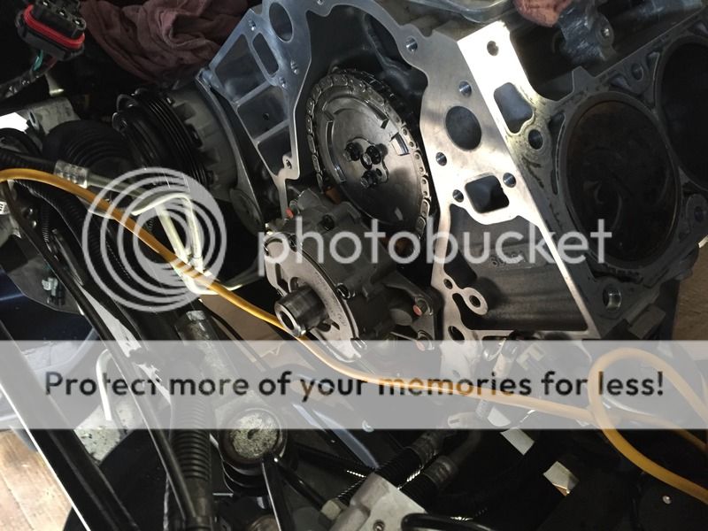

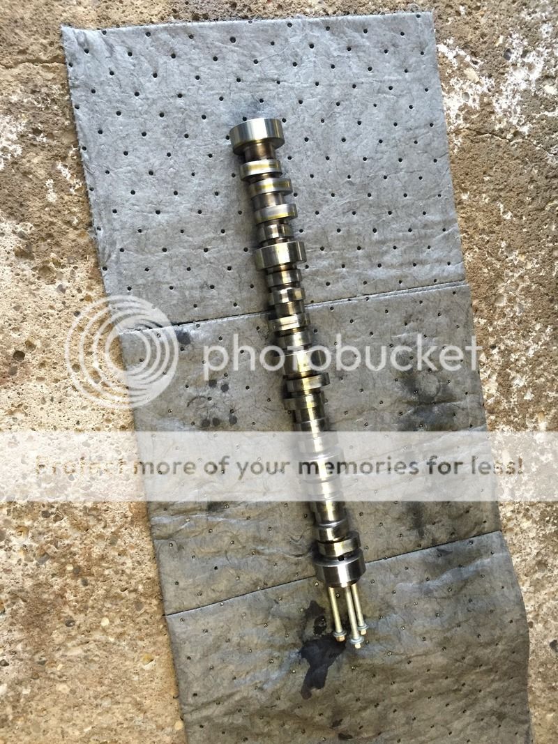

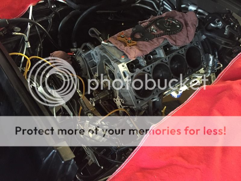

I was able to get the old cam out and new one in last weekend when we had some warmer temperatures. i haven’t taken many pictures during the process but here’s a couple:
I have the balancer and rack back in as well. ARP cam gear bolts, ARP crank bolt. American Racing Headers are being made and will be shipped soon. Cylinders heads are at American Heritage Performance in California for the following:
-new valve guides
-new exhaust valves
-new valve seals
-BTR dual valve springs and titanium retainers
-porting
-milled .020"
Should have them back in a couple weeks. I will need to measure for pushrods but other than that it’s ready to go back together once the heads are back. I have all the gaskets and hardware waiting. I also need to order tires soon. Going with a drag radial on the stock 19s for this year. Clutch and Weld wheels later in the season/next winter.

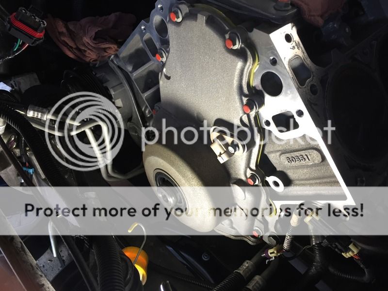

Seems like you know what you are doing, but to be sure a mistake doesn’t happen, be sure that the timing cover bolts stay loose until you install the balancer. They look tight in the pictures.

You are correct, I went back and loosened them up before installing the balancer
