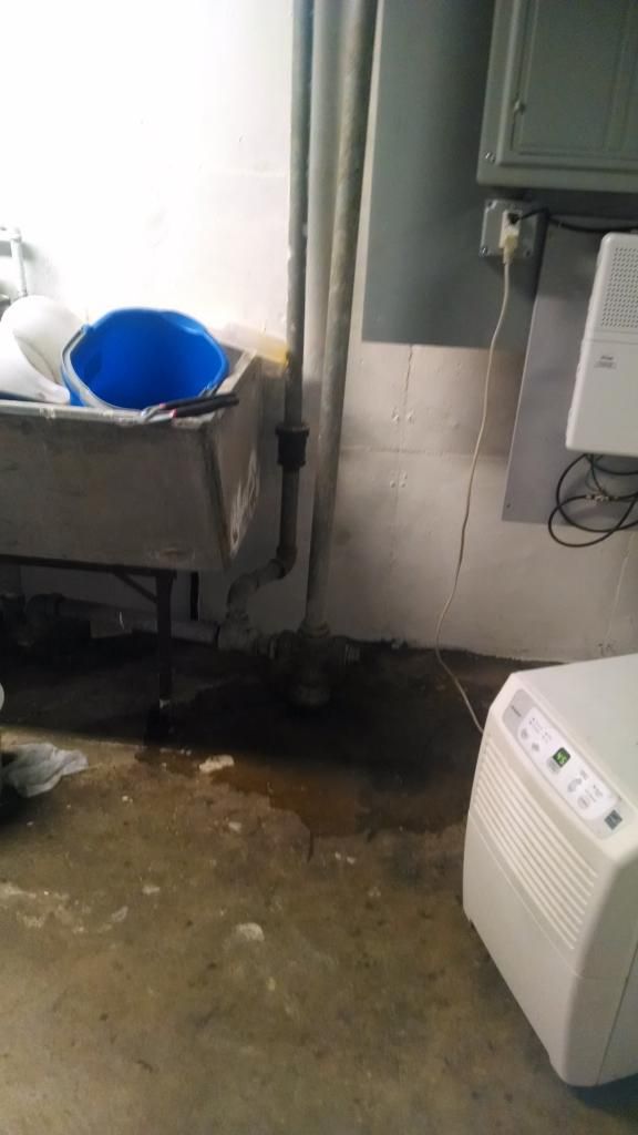

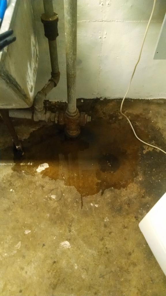

So this has gotten progressively worse. basically the water backs up anytime you do dishes (right above this location) and possibly when the washer is run (to the left of the utility sink). Any ideas?
Run a snake?
x2 on the snake. Those look like galvanized lines and it’s very possible that they are plugged right up. My neighbor just had roto-rooter replace all his lines with PVC.
I told you about this the last time I looked at it. Those galvanized drains are just as bad as the feeds. Short term-snake, long term-replace.
Ditto! Make sure to use a cutter-head on the snake, not just the wire twist tip - therefore have a professional do it.

Called @Gus’s friend from Roto-Rooter. He stopped by and snaked it out with the cutter and everything started draining like a champ. Replacement is on my list to do, but without the money to buy the supplies it’s tabled.
^ So was the problem right there in the house or did he end up cutting roots farther out on the mainline?
I end up getting mine snaked ever 3 or 4 years, always roots. Eventually it will have to be dug up and replaced.

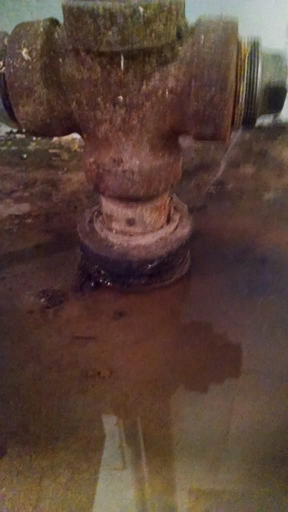

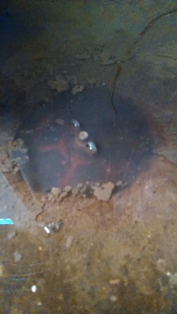

He opened the cap (Picture 3) and tossed the snake down and was hitting mud. It’s one of those “Oh fuck” moments. The pipe had collapsed/deteriorated. He then tried out the main cleanout there, and gave it about 30ft of line. Tested the deep sink there and it was draining without an issue. The collapsed pipe according to him, wouldn’t be an issue since I have a sump pump in my basement.
